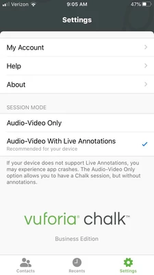

Live annotations have stopped working on multiple supported devices (iPhone 7) after the app update to version 3.1.1. Multiple tests have been made, but this feature is not available anymore.
Error message: "Live annotations are not currently available for this session."
What could be the issue and how can it be solved?

Jun 5, 2020 1:08 PM UTC
Can you confirm both devices being used during the Chalk call, and which was sharing their view? Please also confirm that 'Audio-Video with Live Annotations' is selected on these devices under Settings within the Chalk app.
I just tested on an iPhone 6s running Chalk 3.1.1 and was able to use annotations.

Jun 5, 2020 1:33 PM UTC
Unsuccessful tests were made between two iPhone7, both having Chalk v3.1.1, and between one iPhone7 (v3.1.1) and a laptop (desktop version).
More tests were made between a different iPhone7 (v3.0.2) and an iPhone8 (v.3.0.2), sharing alternatively their view. And between such iPhone7 (v.3.0.2) and a laptop (desktop version). In these cases annotations were working properly.
