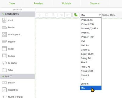

That wouldn't be possible if the amount of objects in your view (canvas) is defined with static sizes. There are too many ways to control the sizes within the properties of a widget or JS code and CSS (even an application parameter can be binded to width and height of a video widget).
The simple way is to use "max" when creating the experience →

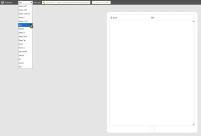

mwodarz_INNEO_0-1767947264544.png and check in preview mode the iPad view with both directions →
