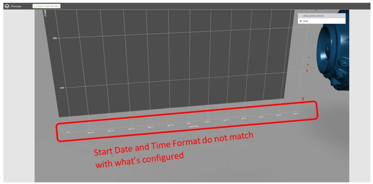

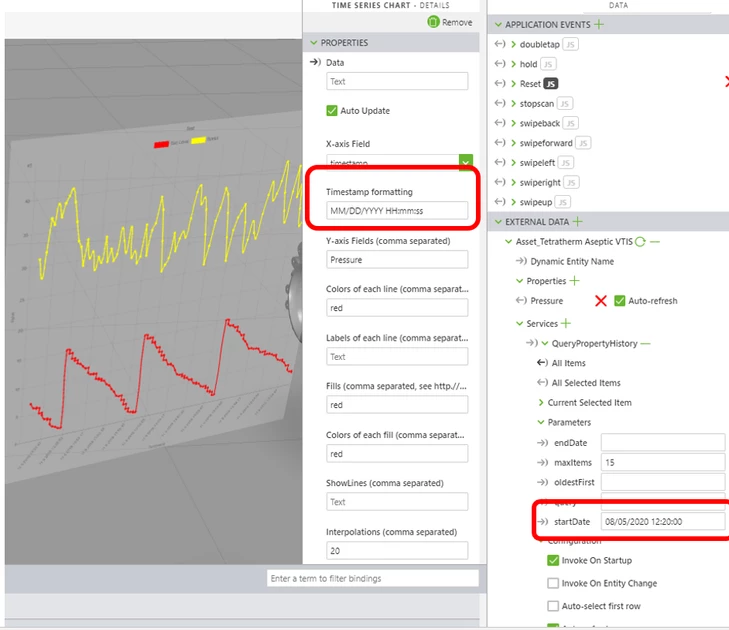

I have difficulties in configuring the timestamp format and start date for the chart. It seems that the widget doesnt correspond to the format I configure (both timestamp and start date value).
Preview result
Studio Configuration

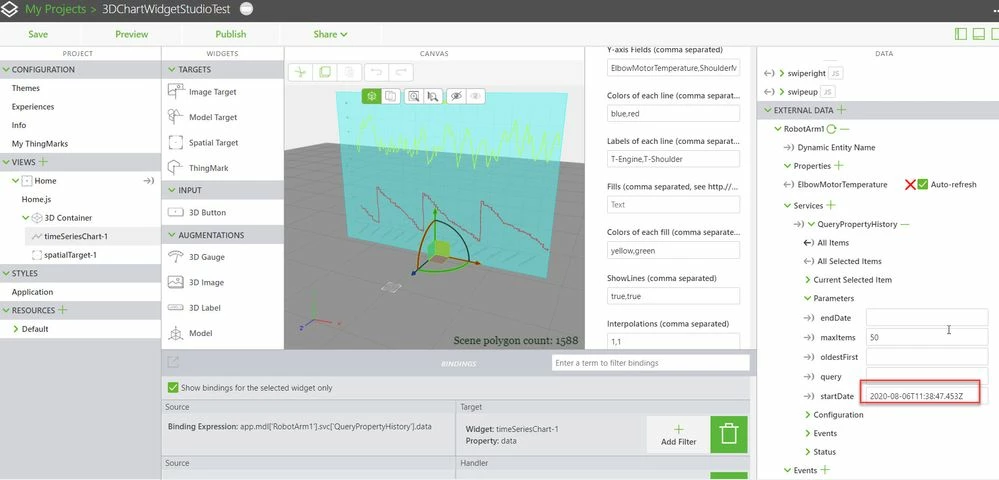

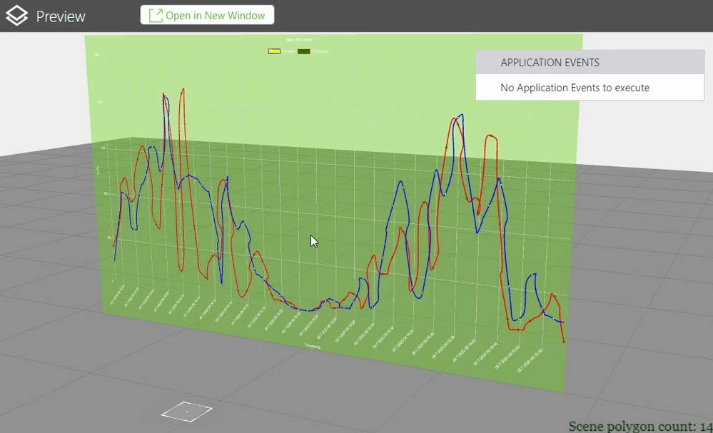

I tested now this widget and it was working fine in preview mode of 3DEyewaere project.
Here the display in preview mode of the 3D chart :

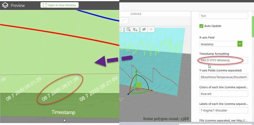

I think according to the date format  - I think there are 2 different points
The one point is the format of the display - this is widget specific  - here the property  Timestamp Formatting:
And so far my observation - it displays correct the timestapm date/time format

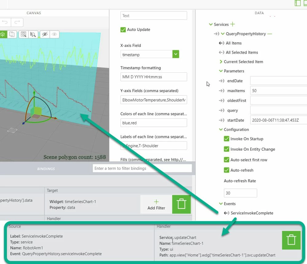

The another point is according to the value what we pass to the QueryPropertyHistory   TWX service. Here I used the same format as the timestamp value in TWX and it was working fine:
so here in example value:  2020-08-06T11:38:47.453Z
Is the same as the table value in TWX e.g. in this sample data:

Thanks for the sharing! I missed out on the startDate format.
