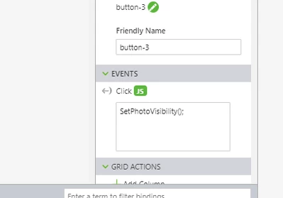

When I click on the 2D button, how do I write a script that makes the 3D image visible and blinks?

Hello. Is this the behaviour you want?
In case this is it, then you need to do the following. Write a function which sets the visibility of the 3dimage and then call it whenever the 2d button is clicked. In the example above, I wrote the following function in the Home.js
$scope.SetPhotoVisibility = function(mode)
 $scope.app.view.Home.wdg["3DImage-1"].visible = !$scope.app.view.Home.wdg["3DImage-1"].visible;
It reverses the visibility of the 3D Image.
Then I set my 2d button to call the function when it is clicked.
You can modify the code to add any kind of behaviour.
