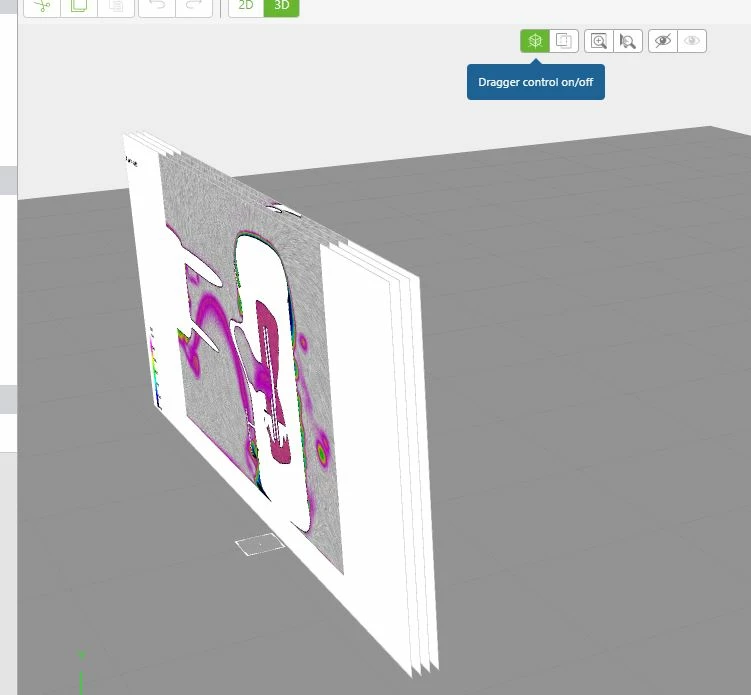

Completely new to all of this and am trying to put together a use case for sharing computational fluid dynamic data in an AR sense.
I have a number of slices from our CFD package saved as .png images.  I can bring these into studio and "walk" round them on a mobile device overlaying a model but I would like them bound to a 2D slider widget so that when I slide the slider forwards and backwards they turn on an off.  In effect I would be sectioning the CFD data up and down a model with a slider.
If you can see the attached image you can see 4 slices correctly positioned.  When the experience loads up the first will be on and the other three not visible.  As the slider is moved to the right the first will not be visible and the next will turn on and so on allowing you to section forwards and backwards.

in this case it would make more sense to have just one 3DImage in the scene and you just load a new image if the slider value changes:
$scope.ChangeImages1 = function(){
 for(var i=1; i< 350; i++){
 if ($scope.app.view.Home.wdg["slider-1"].value == i){
 $scope.app.view.Home.wdg["3DImage-1"].src='app/resources/Default/vu_gauge'+i+'.svg';
So you have just have to change the path in the code above.

Apr 2, 2020 11:34 AM UTC
yes you can do it that way. Your function can look like this:
$scope.ChangeImages = function(){
 if ($scope.app.view.Home.wdg["slider-1"].value == 0){
 $scope.app.view.Home.wdg["3DImage-1"].visible = true;
 $scope.app.view.Home.wdg["3DImage-2"].visible = false;
 $scope.app.view.Home.wdg["3DImage-3"].visible = false;
 $scope.app.view.Home.wdg["3DImage-4"].visible = false;
 if ($scope.app.view.Home.wdg["slider-1"].value == 1){
 $scope.app.view.Home.wdg["3DImage-1"].visible = false;
 $scope.app.view.Home.wdg["3DImage-2"].visible = true;
 if ($scope.app.view.Home.wdg["slider-1"].value == 2){
 $scope.app.view.Home.wdg["3DImage-3"].visible = true;
 if ($scope.app.view.Home.wdg["slider-1"].value == 3){
 $scope.app.view.Home.wdg["3DImage-4"].visible = true;
 Make sure your StudioID's match the names in "" .
