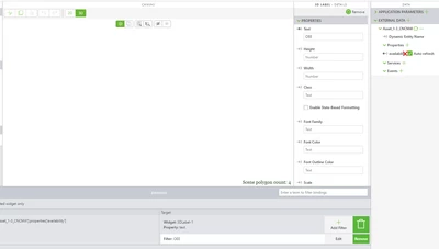

I'm connecting my 3D lable to a Thing and displaying live data... This is working fine.
What I can't seem to figure out is how to get the Data and a Lable to Display on the canvas eg "Tank02 Level: {data Value}"...
As soon as I go to preview the Label Text just gets replaced with binding data...
Any help or guidance would be greatly appreciated...

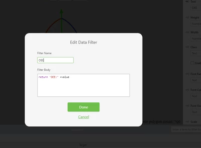

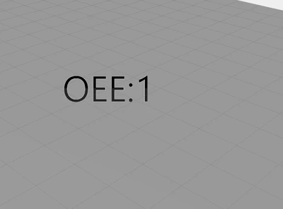

May 22, 2019 9:38 AM UTC
Yes you can use this method also, You have to add filter to value.
