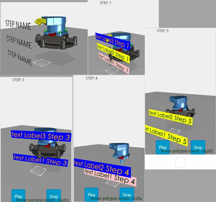

i have button-1  to start a sequence.
Now i want to create an 3D-Label that becomes visible after click the button-1.
And the 3D-Label have to be visible as long as the sequnce is played.
Is there any Js-Code to do this so?
Thanks in advance.
Best answer by RolandRaytchev
Hi @DenGrz ,
here created and tested an example which should demonstrate the suggestion. It is not perfect but should demonstrate the general approach to achieve this goal.

further in the "stepstarted" event the code will set the  values of the widget properties which are contained by the json object  with the same number as the started step number:
$scope.$on('stepstarted', function(evt, arg1, arg2, arg3) {
 var parsedArg3 = JSON.parse(arg3);
console.log("stepstarted stepNumber="+parsedArg3.stepNumber + " nextStep="+parsedArg3.nextStep);
$timeout(()=>{ $scope.setMutipleProps($scope.jsonData_steps[parsedArg3.stepNumber.toString()])},10)
$scope.setWidgetProp('label-1', 'text',"STEP: "+ parsedArg3.stepNumber)
 $scope.$applyAsync();
//this function set multiply properties from a list
$scope.setMutipleProps = function(obj){
 Object.keys(obj).forEach(function (item) {
 for(var prop in obj[item]) {
 $scope.view.wdg[item][prop]=obj[item][prop];
 //print the setting for debugging
							console.log("==>$scope.view.wdg["+item+"]["+prop+"]="+obj[item][prop] )
 $scope.$applyAsync(); };
Finally, I tested it and was working as expected:
I attached the project where I tested the functionality and hope it is helpful for you! Thanks

Hi @DenGrz ,
np, is OK. I could prepare a simple example.
To let check what are the basic / general requirements - so far
-changing the visibility form js code
-moving to specific location. - which location? How is the target location defined? e.g.  - > here what is possible – is  to move - manually the item to a location in UI - and check the values for x,y,z , rx, ry, rz and scale then write them to a table - json file- this will be the easy way to do this - Another way- more difficult is to find a value based on other widget - but this require further considerations and will make it more difficult
- use only one or 2 3DLabel widget and change it for each step
-when we need to display the 3DLabels widget?- and what we need to display  on it? e.g. the current step , the next step ... etc.?
