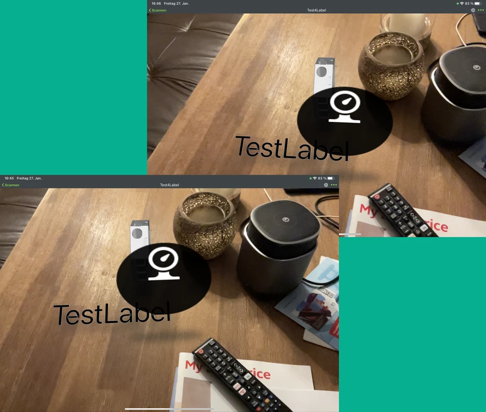

@JR_10180367 , thanks for the feedback. I checked the project by simple loading it to our ES.- public
https://view.vuforia.com/command/view-experience?url=https%3A%2F%2Fmrerot7o.studio-trial.thingworx.io%2FExperienceService%2Fcontent%2Fprojects%2Ftest4label_ipadpro%2Findex.html%3FexpId%3D1
I scanned the project on the iPad Pro(IPad Pro 11 inch 3th Generation) with IOS 16.3 and Vuforia View 9.8.0(2155) but no issue I could observed. So I think the display was ok:
So you can try to scan this project and when you reproduce the same issue - so possibly there was some issue with the device setting. First check the IOS and Vuforia View version. Possibly some special configuration or tool installed on this device?

I just tested again with a brand new project. No CSS, Added 1 label and 1 3D image. Both show up on my iphone. Neither shows up on my Ipad

I just tested again with a brand new project. No CSS, Added 1 label and 1 3D image. Both show up on my iphone. Neither shows up on my Ipad. 2D stuff and 3D model are visible on both ipad and phone
