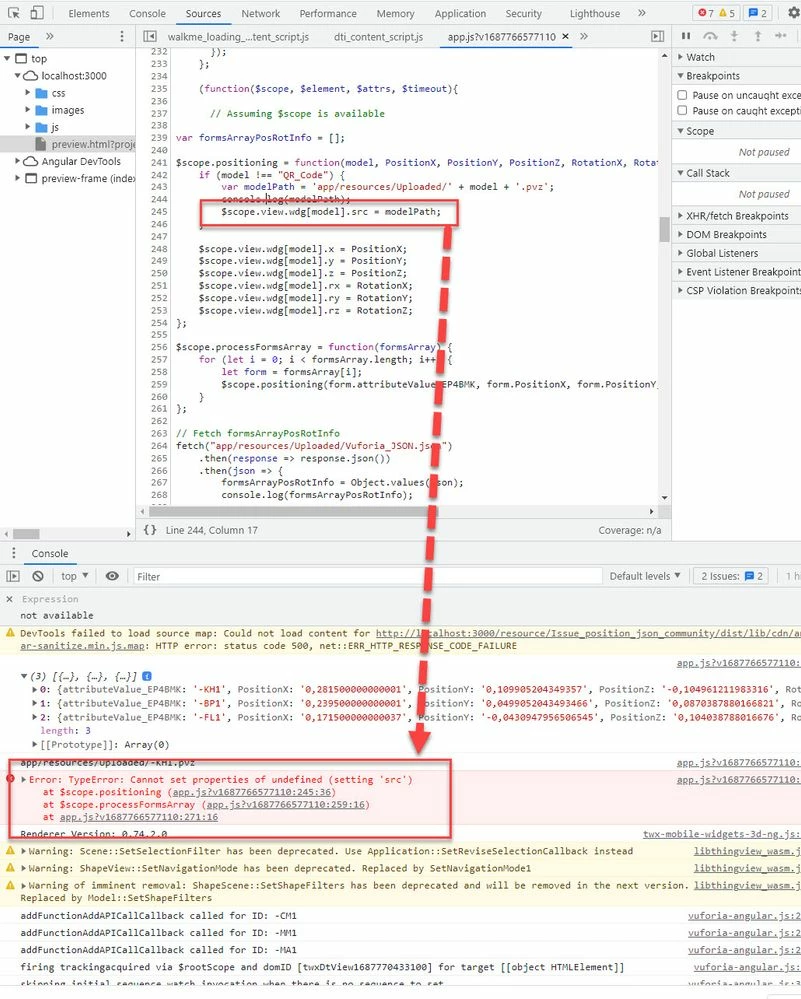

Jun 26, 2023 3:47 PM UTC
Hey Roland,
Big thanks for taking the time to help me out! 🙌
Guess what? I cracked it! 🎉 Turns out, it was a sneaky decimal separator causing the hiccup - I had semicolons instead of decimal points. No error messages or anything, just stubborn positions and orientations refusing to budge.
Huge shoutout to you for lending a hand. You’re a star! 🌟 Anyone running into the same kind of trouble, keep an eye on those decimals!

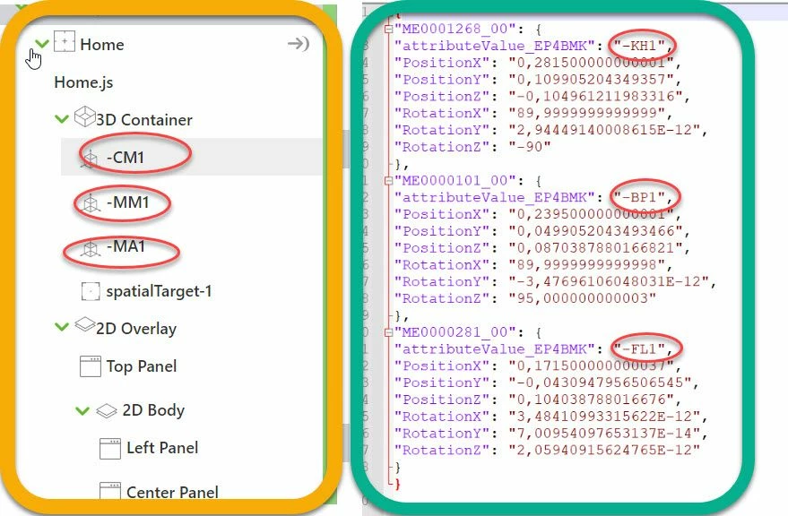

Hi @MM_10532044 ,
I did fast check in the provided project and I so far I could see is  that there are some errors in the consistence between names in the json file and the project Widget names which cause that the code will be interrupted and no any changes will be done
This cause also the issue when you try to set the property using name of widget which does not exist in the current Vuforia Studio Project
Here in this case the Widget name "-KH1" does not exist and therefore the JavaScript part  in $scope.positioning trying :
 $scope.view.wdg[model].src=modelPath;
will fails for a model = "-KH1" because not widget with this name is in the project.
Jun 26, 2023 9:33 AM UTC
I see that possibly there are different versions of this project saved in the rar file. So that I need to check which is the correct json file. I will check and will see if the issue is different. Because there seem to be the correct name. Therefore possibly it will better  to upload the project -when this first is exported from UI and not copied from the Experience Service. - I believe this is a copy form experience service location. I think I have now the correct json version . Sorry for this mixup. Thanks
