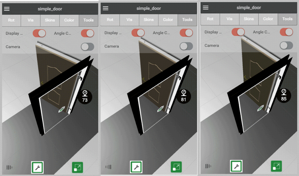

The code above is checking if the value of the app parameter door_angle. The door_angle parameter is bind to a TWX measurement and will change every 1 second where it follows the value of the thingworx measurement.  When the  parameter door_angle  will start a callback function. The function will change to position and the angle of the door where  it uses the door_angle  parameter to calculate the door rotation. Here the door rotation is not the same as the door_angle because we have different coordinate systems and the door_angle should be transformed to a translation and rotation. Sample code:

$scope.$watch(
 function()
 //console.log("$scope.$watch() first function door_angle="+$scope.app.params['door_angle']);
 return $scope.app.params['door_angle'];
 function()
 var l_door=0.999;
 if($scope.view.wdg['toggle-3']['value']==true)
 var angle1=$scope.app.params['door_angle'];
 $scope.view.wdg['slider-1']['value']=angle1;
 var angle1_rad=angle1*Math.PI/180.0;
 $scope.view.wdg['modelItem-door-asm']['rx'] = angle1 ;
 $scope.view.wdg['modelItem-door-asm']['y'] = 0.0 - l_door*Math.sin(angle1_rad);
 $scope.view.wdg['modelItem-door-asm']['z'] = 0.0 - l_door*(1.0-Math.cos(angle1_rad));
 //endif
 //end of the second function
// end of the watch function
