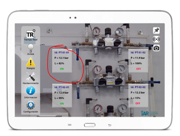

I assume the above screenshot is not from ThingWorx Studio project. However, if you are looking to add background style (as shown in screenshot), you can use 2d widgets (label/text-area/text-input) and add styles to it by adding CSS in "Styles -> Applications"
August 18, 2017
This application developed in some other software.
I want these kind of lable widgets while I develope 3D scens.
Thadeus.D
August 18, 2017
Yes, that is quite possible with Studio. I re-iterate my previous suggestion on using 2D label/text-area widgets, assign a classname and write CSS styling to that class
