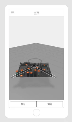

Firstly, Let me give the target product a brief introduction。

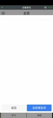

 As following, there are two buttons in the first picture,Click the test button it will jump to the second picture.

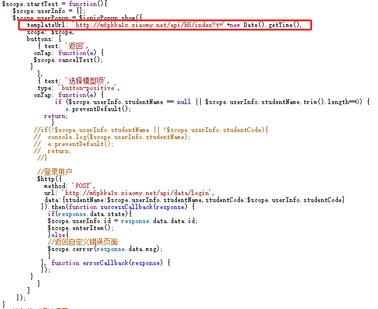

The code of click event is shown as following.
The templateurl  (http://m6pkka1x.xiaomy.net:16002/api/h5/index?t=1634193406439)
is a html called remotely.
Ok, the projects seems very normal on the vofuria studio preview.
Next, when I deploy the project and use voforia view to experience this service.The page cannot be load after I click the test button.
Its  the **bleep**ing problem i wanna to ask u.I already go **bleep**ing crazy.
Finally whats the cause of the problem.I think it may be one of the following situations.
1. is the url above should be a https type? According to  log, this URL was not called at all
2. is the Published process comes up a error that i have missed
3. the log of vofuria studio says a error belowing
Error: ENOENT: no such file or directory, 'C:\Users\Administrator\Documents\VuforiaStudio\Projects\_____2\dist\lib\cdn\angular-sanitize.min.js.map'
can this be the cause of the problem.
