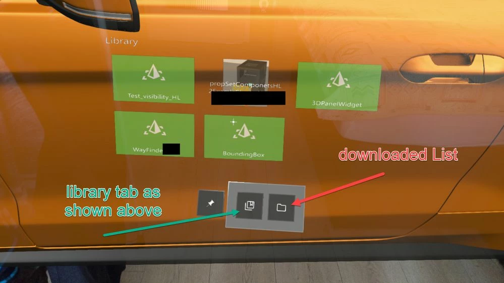

But... I further checked in the R&D reported tickets and found  further information about voiceless usage - menu. So I was not sure if this is already implemented yet or still in development therefore I tested it by myself. So remove Vuforia view app and installed it again on HL2- so my HL has an issue so that this is the way to have an update. Now having the latest version I could confirmed that the option suggested /developed by PTC R&D team is working in the current version (Hey View , version ) 99.15 build 7390
There is a command :  vuforiaview://ptc.com/command/toggle-feature-flag?feature=visual_ui
QR code
This will switch on/off the voice less button UI -> example:20231129_094530_HoloLens.jpg4
So means you can navigate also without voice commands!
