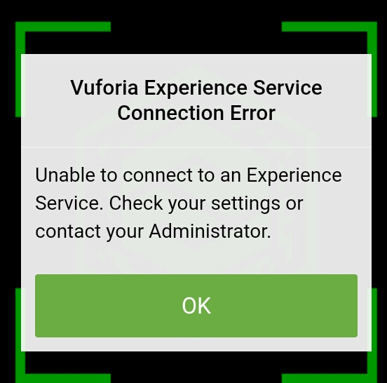

I have made studio connect with Thingworx platform via experience service,and got all data of platform!
But currently,I can't make view contact to ES,
view's URL equal to studio's!
where should I set? platform or ES? And how?
Best regard!!!

@金龙 高 : Could you please confirm if you are using Trial instance of Studio ( version 8.0.x) and ThingWorx 8.0.x ? Or have you setup your local ES instance ?
In case you are using Trail Studio instance, then you should publish your project with a ThingMark using the ES you want to use. Once published successfully, then on Scanning the ThingMark you should get the required Experience loaded into your View app.
Could you please share snapshot of error you are receiving on View ?
-Durgesh

First thanks for having answered my so many questions!
Actually,my studio right is trail version. but Thingworx is not.
I have published successfully.but when I scanned thingmark,the window'll be like below:Screenshot_20170921-170000.jpg
And I want to know if  the trail version studio do have an effect on view?
