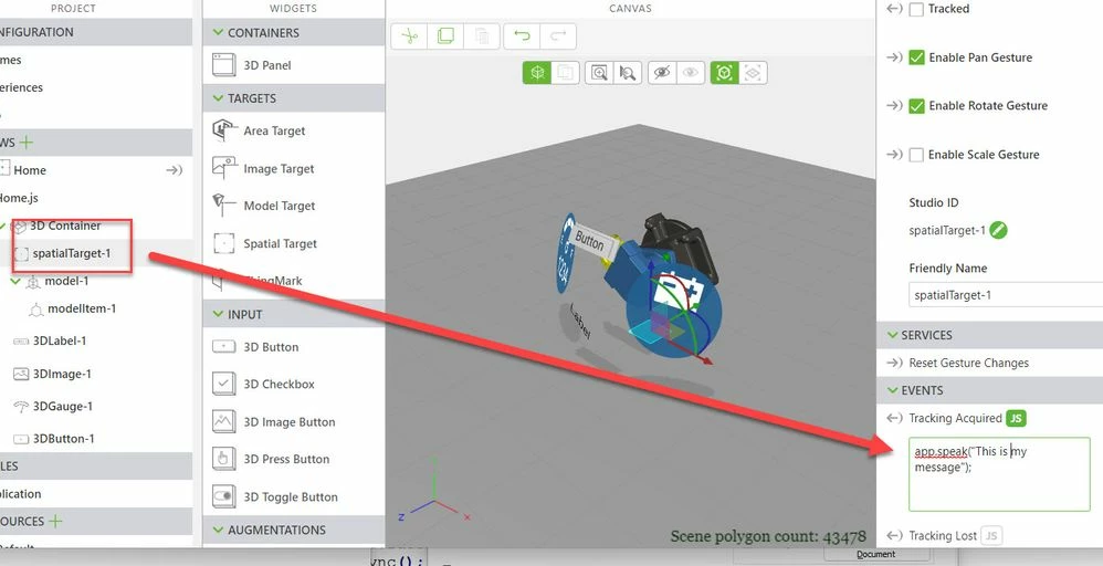

Hi team, I would like to add a welcome voice message to one of the HoloLens projects. It should play once I place the model on the surface. How can I achieve this?

Hi @RK_9880418 ,
for output of spoken text on HL device you could use some code like this:
$scope.app.speak = function (msg_txt)
//return 0; //used speak only for debugging purppose and here is deactivated
var msg = new SpeechSynthesisUtterance(msg_txt);
msg.rate = 2.0;
 console.warn(msg)
window.speechSynthesis.speak(msg);
then call it e.g. app.speak("This my message");
of the spatial target widget.  - I believe you use a spatial widget  when you mentioned that to set position on surface.
