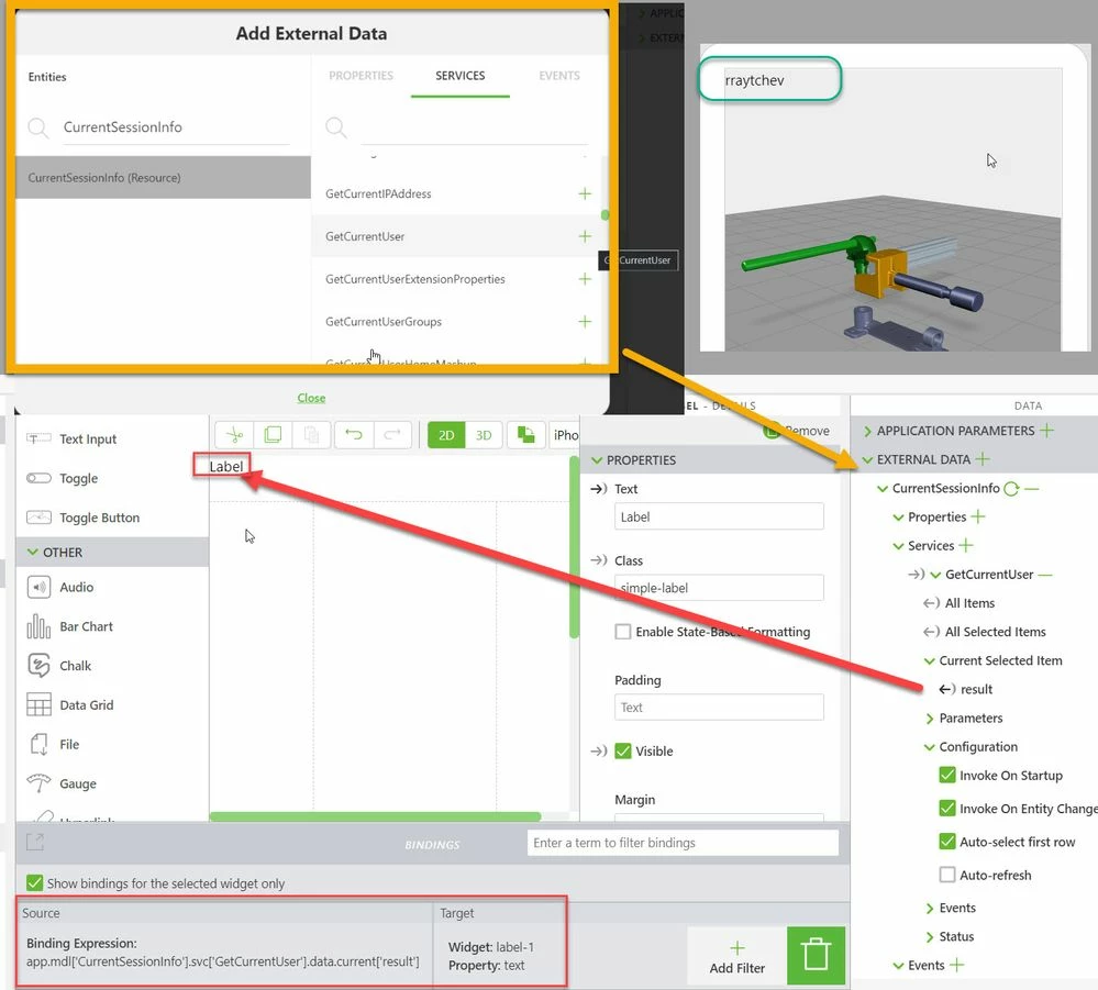

I think this should be possible using TWX service and may be it will be  the best option to implement the whole  service solution  in TWX e.g. here to perform the user request and to write the user to a table.
Regarding to the  first point how  to request the current user in Vuforia I did not check it detailed but I think we need to check the user  which was connected in the session to TWX. We can try to use the service GetCurrentUser  (Resource CurrentSessionInfo) e.g. in Vuforia Studio:
But when I tested it I am not quite sure if this is the real user which logged in the Vuforia View app or is the user what is used by  Experience Service to communicate with TWX because this was not updated (original I logged as admin user) when I used other user account.

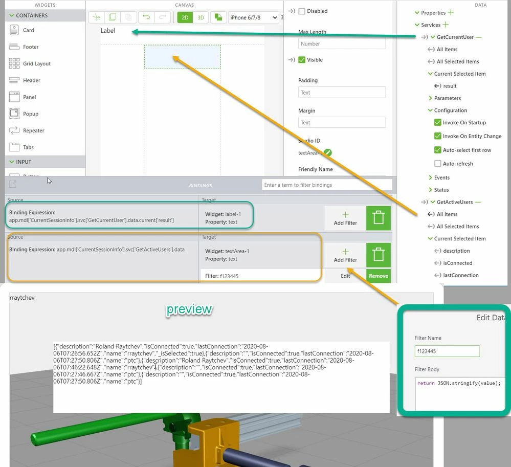

Therefore I checked also the other service GetActiveUsers:
So this service will return a json list of all users e.g. of the test session:
[{"description":"Roland Raytchev","isConnected":true,"lastConnection":"2020-08-06T07:26:56.652Z","name":"rraytchev","_isSelected":true},{"description":"","isConnected":true,"lastConnection":"2020-08-06T07:27:50.806Z","name":"ptc"},{"description":"Roland Raytchev","isConnected":true,"lastConnection":"2020-08-06T07:46:22.648Z","name":"rraytchev"},{"description":"","isConnected":true,"lastConnection":"2020-08-06T07:27:46.667Z","name":"ptc"},{"description":"","isConnected":true,"lastConnection":"2020-08-06T07:27:50.806Z","name":"ptc"}]
I think this contains complete list of all user also the logged into the Vuforia View app users. As mentioned I did not test it very detailed but hope this info could be helpful
