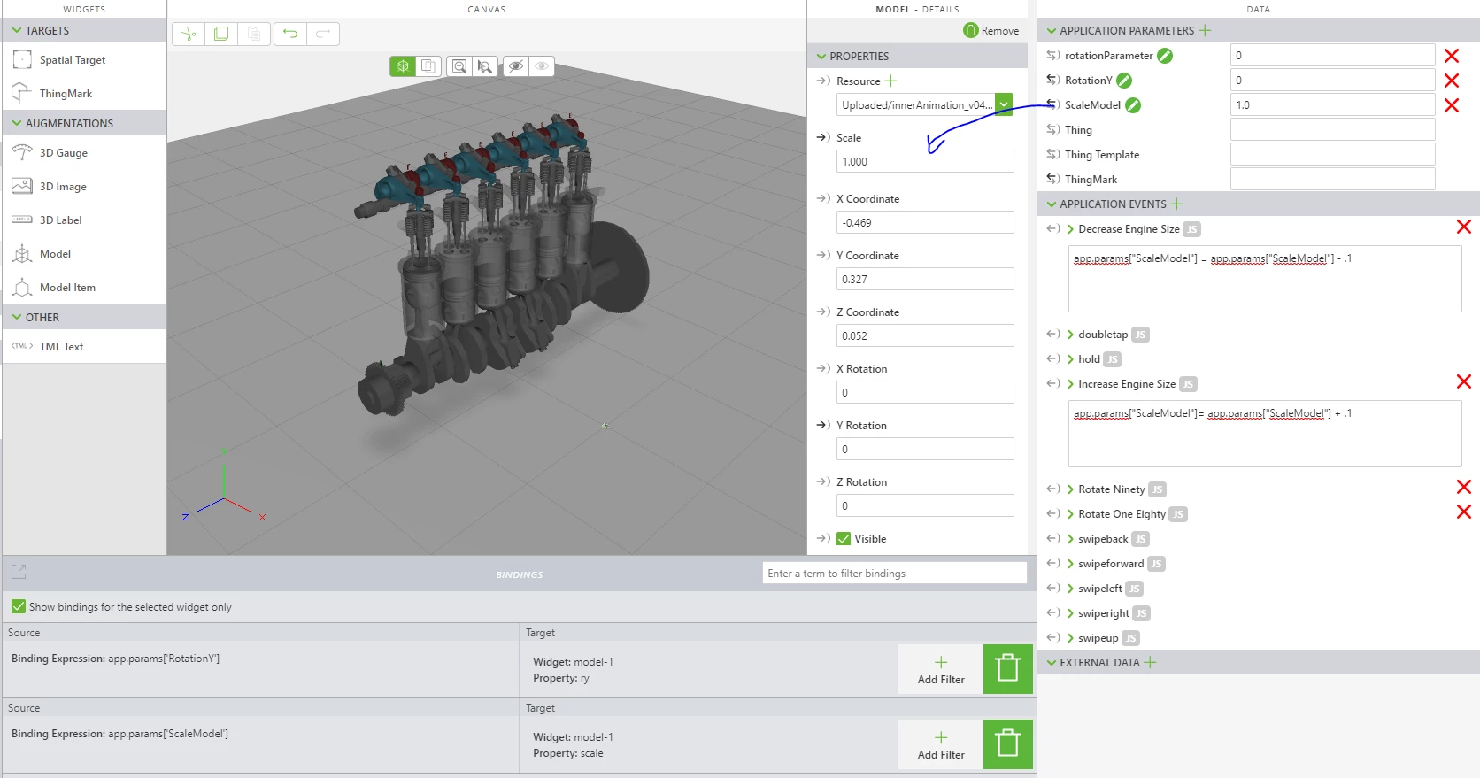

Im attempting to scale the model by 0.1 with voice commands.
If I run "Decrease Engine Size" Voice command then "Increase Engine Size"  it works fine.
reload and then
If I say command "Increase Engine Size" first it does not work and then "Decrease Engine Size" command doesn't work either.
Any idea what I'm doing wrong?
Is there a better work flow?

I have gone through few test scenarios and ran into the same thing. I need to look into this a bit further.
May 10, 2018 6:28 PM UTC
Unfortunately, I don't have a HoloLens to test your example. Using only the preview it worked, but I understand that it is not working on the device.
An alternative that you might try is:
Edit the <<ViewName.js>> and paste the following code:
$scope.SizeIncrease = function () {
 $scope.view.wdg['model-1']['scale'] = $scope.view.wdg['model-1']['scale'] + .1;
  $scope.$applyAsync(); } $scope.SizeDecrease = function () { $scope.view.wdg['model-1']['scale'] = $scope.view.wdg['model-1']['scale'] - .1;
*** "model-1" should be replaced with the name of your model.
On the Decrease Engine Size JS event:
    viewCtrl.SizeDecrease();
On the Increase Engine Size JS event:
With this method, you would not use the ScaleModel parameter and it's binding.
I hope it helps!
All the best,
Ricardo

These steps worked for me...  (Edit from my original post).  After further testing, I'm running into the same issue where I have to say "Decrease Scale" prior to saying "Increase Scale".  Be nice if a solution was found for this little bug.

I wonder if maybe this is a variable type issue, where in some cases it interprets the parameter as a string rather than a number. Maybe give this a try:
 $scope.view.wdg['model-1']['scale'] = parseFloat($scope.view.wdg['model-1']['scale']) + 0.1;
 $scope.view.wdg['model-1']['scale'] = parseFloat($scope.view.wdg['model-1']['scale']) - 0.1;
