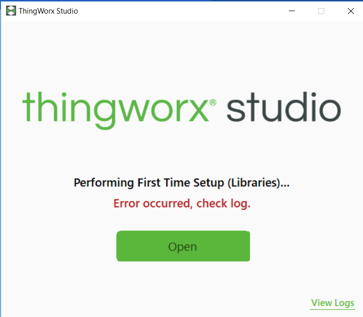

am facing an error while installing STUDIO. For details refer the 2 attachment.
  • June 1, 2017
  • 1048 views

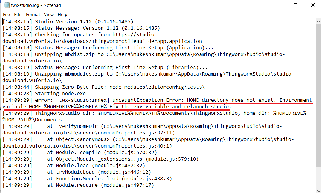

Thingworx studio cant be installed..it is showing the below error..For details ,see the below image.

What do you get when you do a "echo %HOMEPATH%" in the command-prompt? You can also try executing "SET" (in cmd mode) that returns all the existing environment variables and search for variables "USERPROFILE" and "HOMEPATH". Usually, Studio will automatically look for these two locations to create/store project files.
