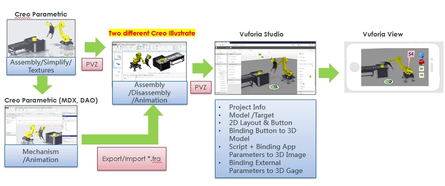

sono arrivato fino al punto 6 poi non capisco come fai ad aprire due illustrate.
Me lo puoi spiegare meglio?
Grazie mille.
Aug 4, 2018 2:53 AM UTC
Hi Matteo,
Creo Illustrate can't create animation and kinematic mechanism  easily. We can use workaround to this instead of Creo Illustrate animation. You can refer to the link below for more detailed information.
https://community.ptc.com/t5/Studio/Is-possible-to-Play-an-Animation-not-a-Sequence-in-TWS-from-Creo/m-p/545977
Aug 19, 2018 6:13 PM UTC
Hi JingMao Cheng,
I managed to create the sequence passing from the animation. (PROCEDURE: once you have loaded the .fra file done with the mechanism and created the animation, I copy the frame and move to the sequence without using 2 licenses).
In illustrate version 4.2, everything works correctly (see file illustration2.c3of)
When I load the pvz in Vuforia studio and I go to use this sequence it does NOT work. The preview even stops. (See experience: PROVA_RONDO.zip)
A questo link trovi i files: https://we.tl/t-Oq2ITieWhD
