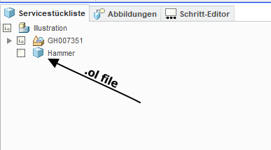

    Hello !
    You can import symbols into creo illustrate to select and use them in sbom.
    The symbols (.ol) are located at
    C:\Users\<username>\AppData\Roaming\ptc\Illustrate\SymbolsLibrary\Shape
    @Moritz von Hasselbach
    How you can add "annotations" from creo illustrate into sbom ? Are there any other .ol files you can import or? I only see .gif a picture format.

    Feb 7, 2018 2:34 PM UTC
    Hi Erik,
    annotations like text labels are not supported in Thingworx Studio either. I know that PTC R&D is working on a unified format for annotations and sequences in Creo Illustrate. I think it's already supported in 4.1/4.2 to a certain  degree - but the resulting figures won't work in Thingworx Studio as of now. I hope that we'll have support for more Creo Illustrate features as soon as we support the unified format in Thingworx Studio.
