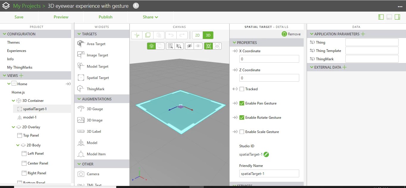

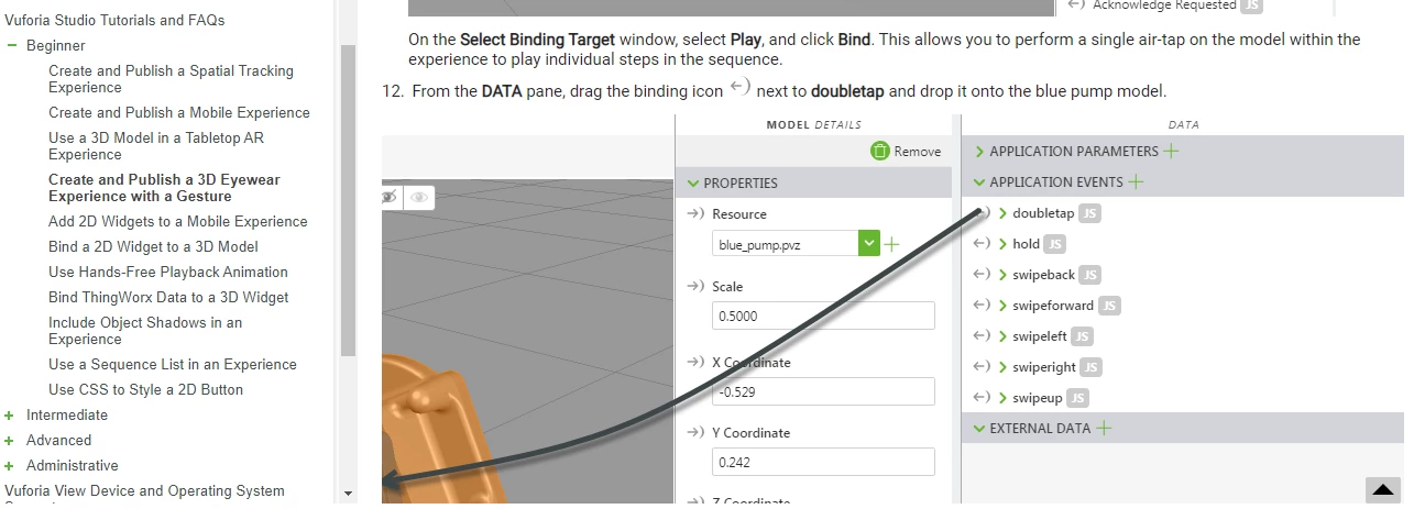

Hello Community,
By using PTC guide, I created 3D eyewear experience with a gesture project. In that, I have to do drag double tap from application event. But whenever I create project, then application event is not visible. What to do to get it visible. Here I attach file please check this.

Hello @NP_10149671 ,
Can you please share the project file and also a full screen screenshot of this ?
Also, are you experiencing this with every 3D-Eyewear Projects ?

9-Granite
Jun 17, 2022 5:53 AM UTC
Hi @Mohit_Kabra27 ,
Here, I attach project file and screenshot. Please check with this.
Yes, I experiences this issue with every 3D-Eyewear projects.

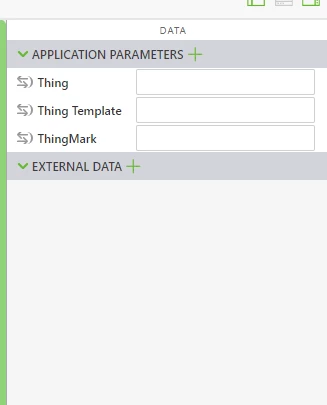

Jun 17, 2022 6:24 AM UTC
Hi @NP_10149671 ,

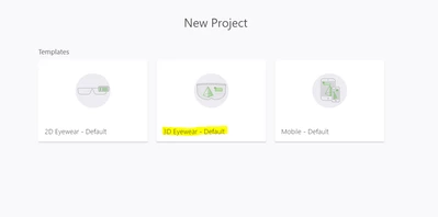

As i can see from the screenshot, you have not selected the 3D-Eyewear template at the very first place and hence not able to see the application events option. You are currently using the Mobile template.
If you want to develop a 3D-Eyewear project ,you need to select the same template as shown in below image and then start building your experience.
Let me know if you still face any issue.
