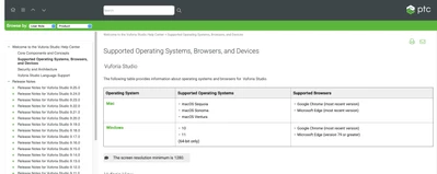

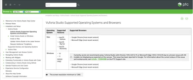

I wonder if Vuforia Studio is supported on Apple hardware (for example a MAC mini) with an M4 CPU. Are there any known issues?

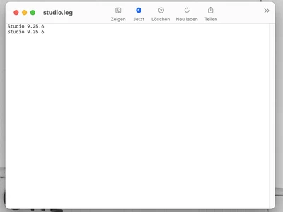

Every time when the user tries to start Studio only one line is added to the log:
pjahn16-PearlAuthor
