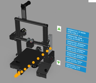

Please advise how I can solve the issue; I animated 3d arrows in Creo Illustrate but they did not show up in Vuforia Studio. Can I still make the show up somehow? Arrows go all over the 3d model to point users to little parts so I wish I can keep them. If you know a simple solution to point user to little  hidden parts please advise.

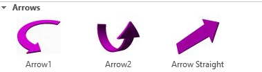

Currently arrows do not transfer (in the past I used models added to the bom structure - see attached arrow ).
Another approach is to use Waypoints

@sgreywilson Thank you so much for the solution. I have started to learn the Wayfinder widget. Could you please share this project so I can learn?
Aug 28, 2023 2:01 AM UTC
This video should help https://www.brainshark.com/ptc/vu?pi=zJ5zicwUVzBRxnz0
I don't have a simple project - The one in the video has that  Pager panel which is a little complex and probably not a good example - I developed the pager for HoloLens and just copied it into this to explore Waypoints.
This extension might help https://github.com/stevegw/COEWayfinderPoints

Only models in the sBOM (service structure) are transferred to Vuforia. For this reason I have duplicated the standard OL files to insert them into the service structure. Attached, you'll find these files. Note that many files have been duplicated so that they can be imported multiple times for different sequence steps.
Hope that helps
