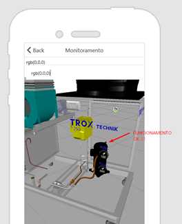

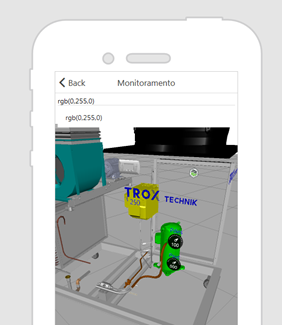

    A variável é atualizada corretamente (fiz o teste colocando um Label com o Valor na tela), e no preview no PC as cores mudam corretamente:
Porém, no dispositivo (tablet ou Smartphone) o item não muda de cor.

This is an use case that the customer has where he wants to change the model item color based on a property from TWX. He created a service in TWX that sets the variable cor_compressor
                       if(me.Compressor_TENSAO_COMP > 10.0) {
                                      me.cor_compressor = "rgb(31,131,5)";
                        else me.cor_compressor = "rgb(0,0,0)";
After this they link this property to the model link color.
It is working in the PREVIEW but not in the View App.
