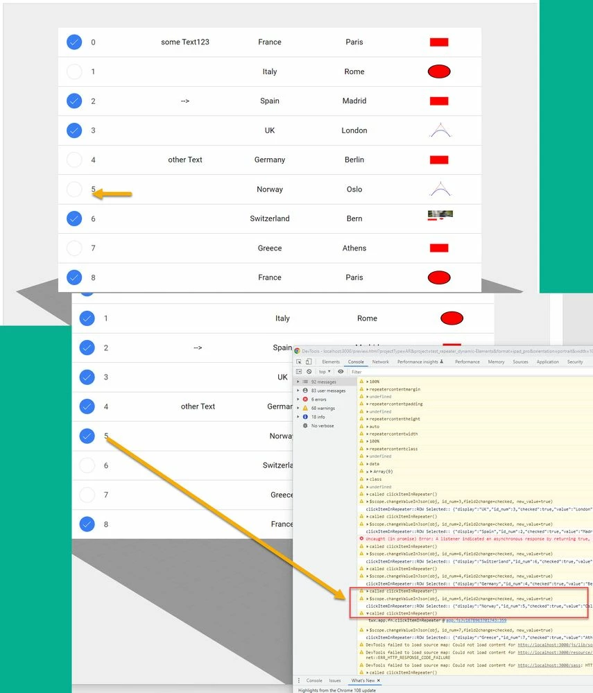

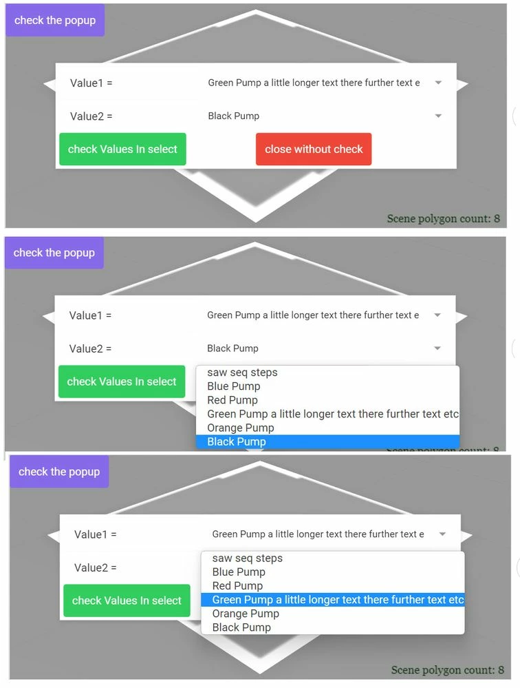

Hi @PI_10616642 ,
there are different ways to implement muti choice . Depending on the data, how long should be the info text etc.
- So for example  here 2 possible option
  1. you can use a popup with list elements - select widget:2023-03-16_11-52-59.jpg
  2. or you can use 2d repeater Widget to implement some multi choice :2023-03-16_11-59-13.jpg
but there also other widget could be used. So it depends on the design of UI what you want to implement
but generally there is no a standard way to do this. Means every user could implement this what is the user understanding for multichoice , depending on the particular requirements
