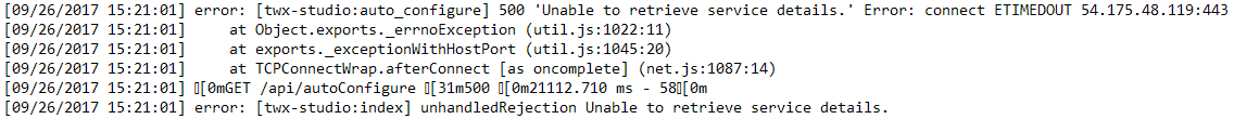

When I attempt to sign into the 'Login Portal' in Thingworx Studio, I receive the following error:
Then I check the log for errors, which gives me the following:
I have uninstalled and reinstalled the program. Could somebody please help me resolve this?

hello,
i get the exact same error message + this inbetween:
Error: connect ETIMEDOUT [random ip]
edit:
found this other thread with the linked solution article
Problems: Configure Log In - ThingWorx Studio

Goran, Were you able to resolve your issue following the article solution?
It was helpful for root cause detection. My corporate notebook/network seems to block the automatic configuration.
Putting the IP from log into the "Experience Service URL"-field at project creation works however.
(http://www.[insertIPfromLogHere])
