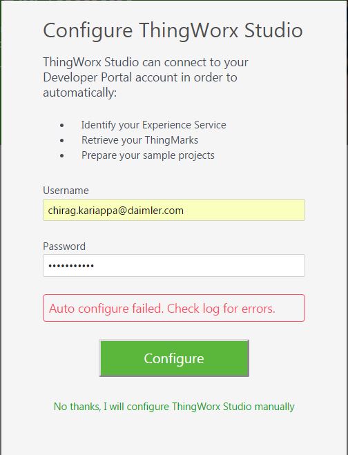

Auto Configure Failed
When i try to login to ThingWorx Studio at the "Configure ThingWorx Studio", I get the "Auto Configure Failed. Check log for errors" message.
Please find the attached Logs and Screenshot.

Hi Chirag, Based off the log file you shared, there seems to be a connectivity issue. Could you please try configuring Studio on a different network?

I have the same thing.  Bad word choice.
I have the same error .

[16:22:43] error: [twx-studio:auto_configure] 500 'Unable to retrieve service details.' Error: getaddrinfo ENOTFOUND studio.thingworx.com studio.thingworx.com:443

Check out our knowledge article about this issue. Let me know if you run into any problems. ThingWorx Studio Failed Connection Issues

Got a little further.
Plugged in the Proxy URL and the default experience url.
Am now getting a new error below, certificate related.

[14:43:25] debug: [twx-studio:auto_configure] dev_portal_url https://studio.thingworx.com/api/v1
[14:43:25] error: [twx-studio:auto_configure] 500 'Unable to retrieve service details.' Error: unable to get local issuer certificate
