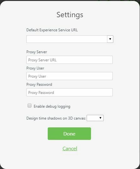

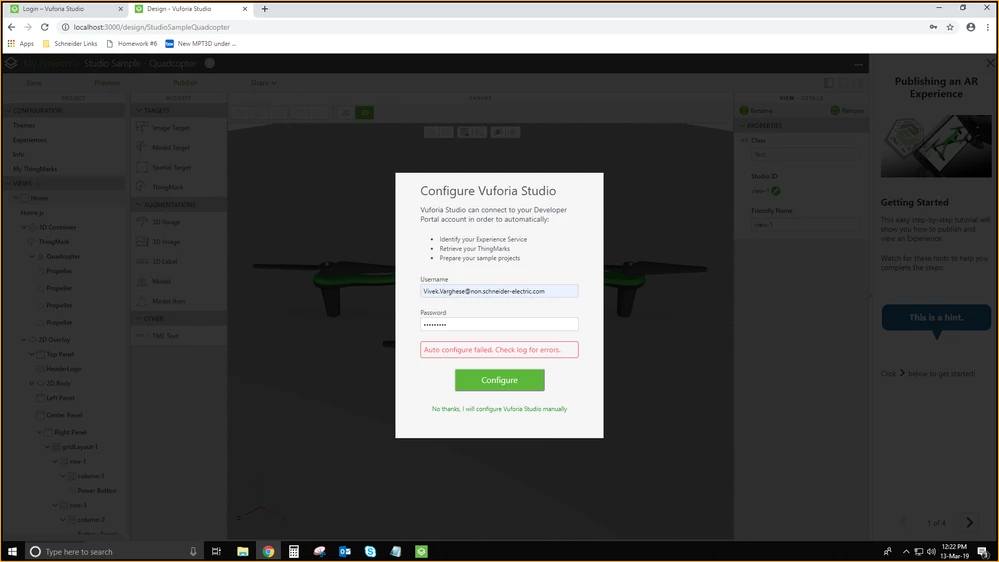

Thanks for sharing your log file. I am seeing some network timeouts in your log. Most likely a network/proxy issue. If your company is using a proxy, you'll need to enter the proxy information in Studio as Studio does not inherit the browser proxy settings. You can configure the proxy in the 'Settings' menu.
Please work with your IT team to help ensure traffic to 52.2.234.5 & 52.20.153.137 is not blocked.
