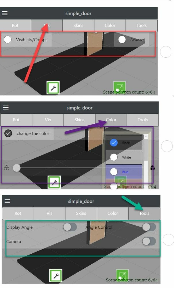

Apr 23, 2020 3:29 PM UTC
Hi @DenGrz ,
it can be done with javaScript as mention by   but there is also simple option using the Tab widget. In some cases, it could be ok as shown on the picture:
So here you need to add the Tab widget and add for the different functionality different Tabs where you place the different buttons, checkbox ... etc. The show and hide of the groups is then done by the widget default functionality.
DenGrz1-VisitorAuthorAnswer
Apr 24, 2020 10:58 AM UTC
Thanks for the fast reply.
That´s a good idea, i try it.
