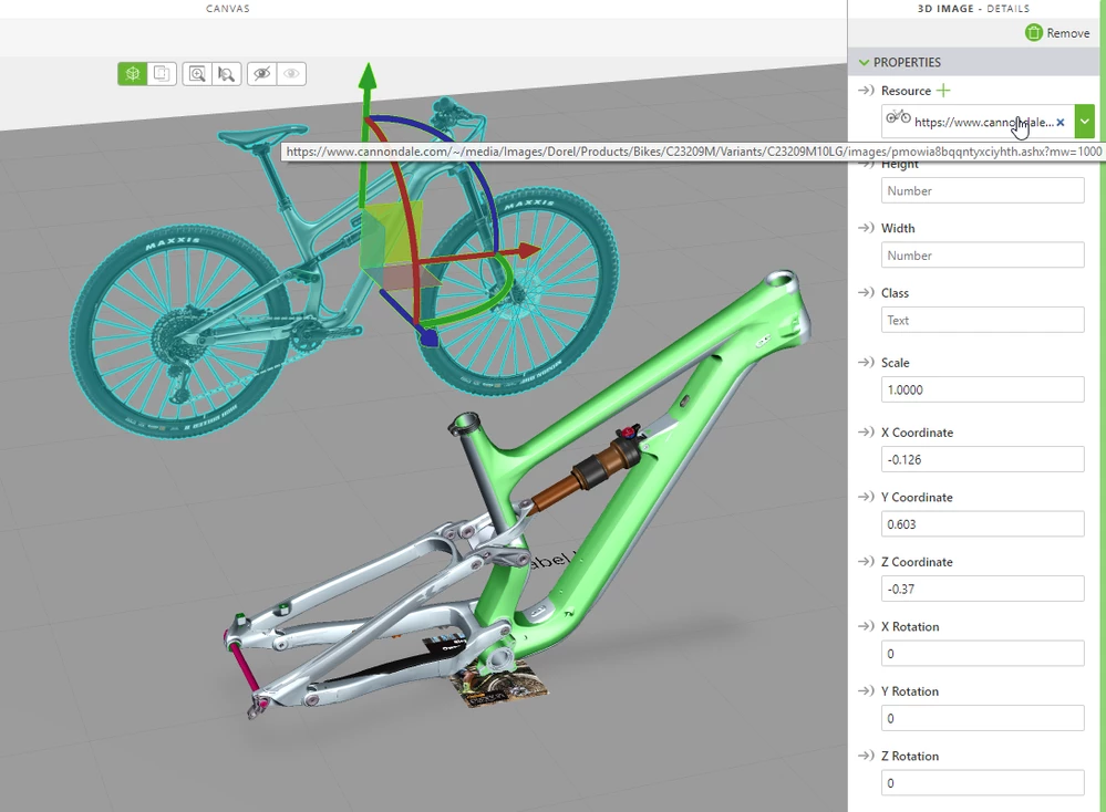

In Studio you can enter any image URL in the "Resource" field for the 3D Image widget, it can seem like that is only a drop down box of your uploaded resources by you can type into it.
As for changing out the images you are going to have to figure out the Select 2D widget and probably write some JavaScript code.
As a word of warning you can not change the height and width value of a 3D Image during an experience. However you can change the scale of the object. So you are going to need to make all of your images the same aspect ratio say, you can pad out the images with transparent background and that will be respected in Studio.
