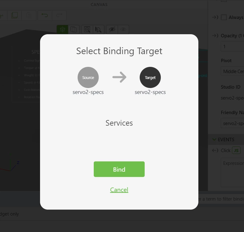

Bind application events with 3D model(hololens development)
I would like to bind events when developing for the Hololens. E.g make a Gauge visible with a hand gesture or voice command in the Hololens. However I do not get any services available when trying to bind it.(ref attachment)

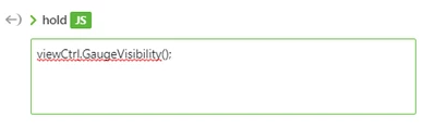

Hi @lundha ,
As far as I know, the application events can be bound to a service to complete actions like playing a sequence. One of the ways to alter the gauge visibility is by defining a javascript function on Home.js and call it in the application event.
$scope.GaugeVisibility = function()
 $scope.view.wdg['3DGauge-1']['visible'] = true;
Screenshot_34.pngHope this helps!
