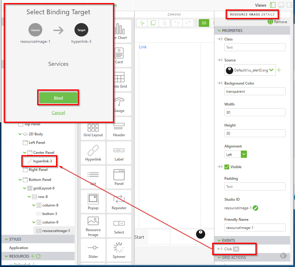

I want to use an image as a kind of button to open a hyperlink. So i created a hyperlink and an image.
When i want to bind the click event to the hyperlink, it shows the popup but it is not possible to bind.
Tested on 2 different users / systems using Chrome as browser.

Neither of the widgets mentioned here have click events... I think we need more specifics, and maybe a screenshot.
Aug 31, 2017 6:52 PM UTC
Stefaan Vlaminck​: I believe you are pointing this in reference to ThingWorx Studio 2 D widgets - Image & Hyperlink.  I would suggest to use a Resource Image instead and call JS function on its Events.
-Durgesh
Aug 31, 2017 6:58 PM UTC
Also, on your point  "When i want to bind the click event to the hyperlink, it shows the popup but it is not possible to bind" seems to be a defect and will further raise it Product Management team to be reviewed and get fixed.

Helo,
Here is an image of the issue.
Sep 6, 2017 9:00 AM UTC
Stefaan,
I am experiencing this "defect" also. I would like to be able to set the Click event to bind to a hyperlink, but I get the same blank services pop up box.

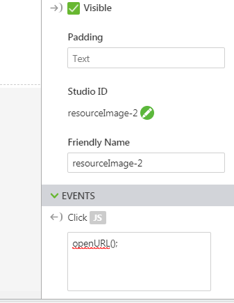

Stefaan Vlaminck​ Brian Whelan​ If your objective is to navigate through the url on 'Resource image' widget click, then you can also use JS code to do that. Technically, you can write a JS function that sends request to the desired url and certainly have the widget click action to trigger the JS function:
Oct 10, 2018 1:16 PM UTC
else
window.location="https://isap.de/";
But then I can not return to my expirience. I only can scan it again. When using the hyperlink widget, there is an icon to return to the expirience.
How has the js code to look like, when i want the behavior of the hyperlink widget?

I might have misunderstood the requirement here, but it sounds like you want to have some sort of custom image as a button and when you click on the button, it opens a hyperlink.  Is that is the case, then you can user the Hyperlink widget and format it using CSS to appear as an image.
Have a look here for the details: How to attach link to the image button widget?

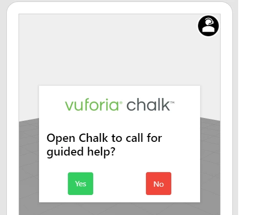

Oct 11, 2018 11:09 PM UTC
Ahhh.  Not a perfect solution, but you could create a 2D pop-up and that has the hyperlink in it.  So when you click on the 3D image the popup comes up and has something like "Browse to the web for this item?" and you have a hyperlink for yes formatted to look like a button and the No button just hides the popup.
I've done this to launch Chalk calls from within Experiences.  When I click the support button, a popup comes up like this:
And I've seen what you mean about the JS code.  Every example that I've seen that does this launches the webpage inside the experience so there's no way to go back.
