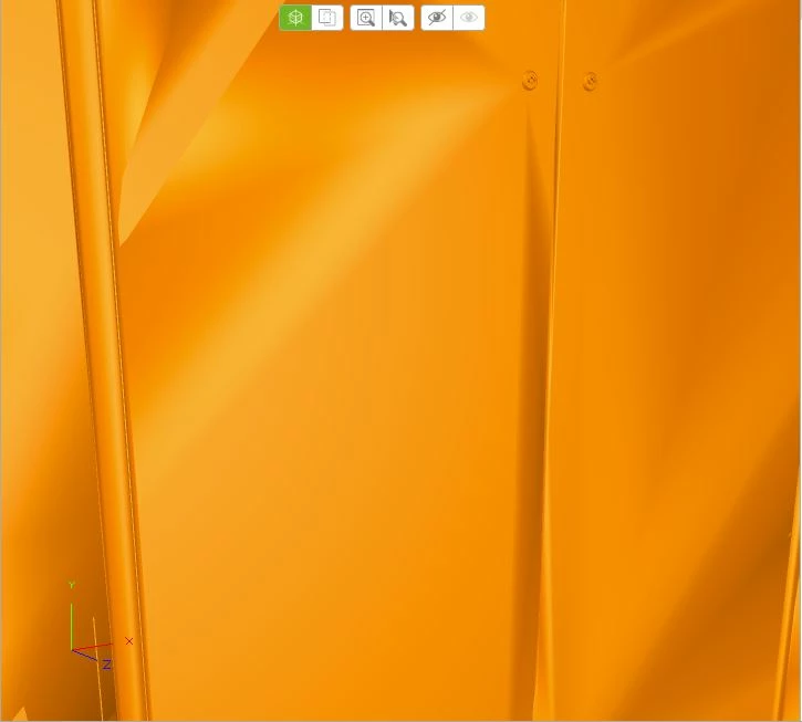

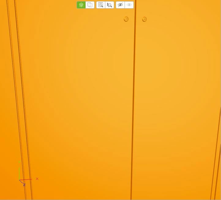

Hi everybody,
I have a project with three industrial machines. I have removed a lot of parts from the inside in order to get the app run fluently. Nevertheless does loading of the models in high resolution takes about 7 seconds. If I use medium quality, the flat surfaces look like being crushed. Is there a way to have medium res. without the distortion?
The surface in the picture is about 2m high
Greetings
whity

Aug 31, 2018 3:32 PM UTC
What are the file sizes for your original .pvz and the optimized ones? You can find all these files VuforiaStudio\Projects\[project name]\src\phone\resources\Uploaded

Sep 3, 2018 7:59 AM UTC
The original pvz has 11.9MB, High has 11.7, Med has 4.6 and low 3.36MB.

Sep 3, 2018 1:23 PM UTC
You might have already seen this:  CAD optimizer eliminating parts
It's a bit of a black art that doesn't seem to be documented anywhere.  I'd just try changing the values on the sections and see what you get.
I do think that to swap out 17 files isn't too many, but I understand that you don't want to do this all the time.
