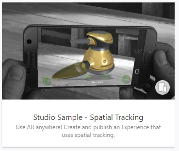

I"m not quite sure what you mean by a camera image.  I"m guessing you mean some sort of printed target like a ThingMark or an Image Target.  If you just want to place the model on a surface, then you can use a Spatial target.  If you've got a really old device you won't be able to use it.
You should look at the sample project that comes with Studio for an example:
You should also look at the tutorials in the help: http://support.ptc.com/help/vuforia/studio/en/#page/Studio_Help_Center%2FBeginnerIntro.html%23
And the AR training class in PTCU: https://www.ptcu.com/enrollment/student/fundamentals-of-ar-development-with-vuforia-studio
