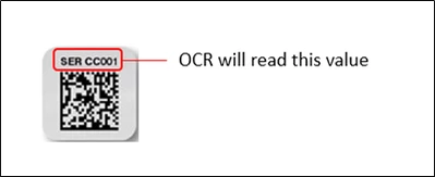

I want to capture data matrix label since data matrix scanning not available in Hololens II. Then, OCR will read the data matrix value. Example as picture below:

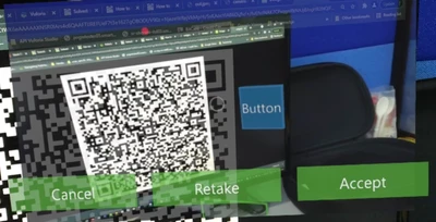

So, below is sequence of how camera widget work in Hololens II.
1. 3 seconds countdown
2. Camera sound
3. Image preview with cancel, retake accept button
But in this case, there's a delay around 2~3 seconds between 2. Camera sound and 3. Image preview.
Is it possible to customize camera widget to eliminate :
1. delay
2. cancel, retake and accept button
I would like the camera to auto-accept image like usual camera work which image automatically taken on user click shutter.
