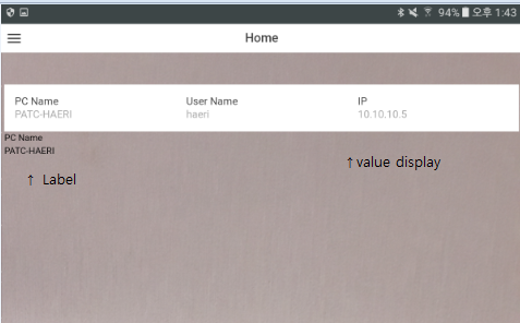

Hi
I'm making a demo project by thingworx studio.
I wanna change a background color of '2D' widget.
When I use a 'value-display' widget, the background color is white and font color is black.
Also, I want to change a color of button widget(2D).
Is it possible? if it is possible, please let me know how to do.
Thanks.
