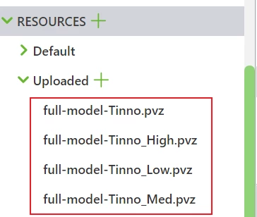

Can I find cached pvz model in my computer?
I used CAD Optimizer to optimize the model. Are these optimized models(.pvz model) that are cached in a local folder?
In other words, Can I find these .pvz files on the local computer?
The reason WHY I want to get these models is that I want to open this model in Creo View, but the current model format is.IGS, which cannot be opened by Creo View.  So if there is another way to let me open this model in Creo View, I am willing to try.

Hi @ZL_9884170 ,
please check in your project folder. In the normal case it should be in the Document  subfolder
%HOME%\Documents\VuforiaStudio\Projects\<YourProjectName>\src\phone\resources\Uploaded
let say you HOME variable is set   C:\Users\userXYZ     and your Project Name is TestPTC
In this case you can look then into
 C:\Users\userXYZ\Documents\VuforiaStudio\Projects\TestPTC\src\phone\resources\Uploaded

Oct 29, 2021 6:01 AM UTC
Thank you very much!I found the file I was looking for!
