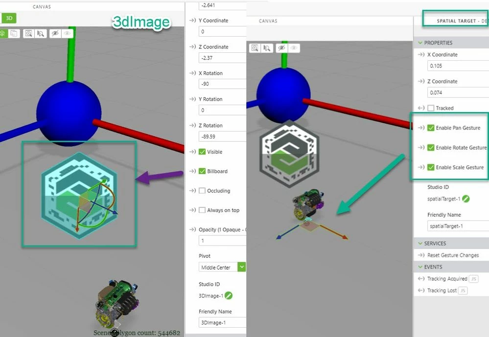

Can I zoom in the image with finger gestures?
Can I zoom in ( out / translate ) the image with finger gestures?
i display manual image ( 2D ) and i will use finger gestures
zoom in / out / translate
is it possible?
Nov 8, 2019 9:20 AM UTC
Hi @wxywxy1 ,
so far I know, is not possible for 2d elements to zoom via gesture.
Currently you can use Pan , Rotate and scale for 3d elements in experiences with spatial targets. So, for example if you use 3dImage Widgets (e.g. with Billboard property set) you could have a similar effect.

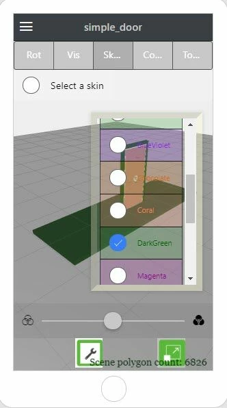

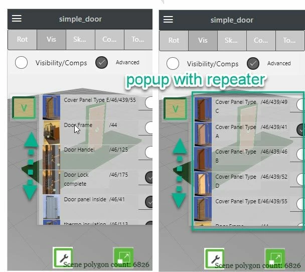

Are there any examples created using 2D widgets?
The zoom function is replaced by a button,
Can I move images using scrolling?
Nov 11, 2019 1:45 PM UTC
Hi @wxywxy1 ,
I think , pan of 2d elements located on the panels (2d body /canvas)  or inside a Grid is not really possible so that scrolling by the default behavior could work but this depends on the particular device - pan via scrolling could not always have the same behavior (e.g. difference between android and IOS)
I remember that when we have many 2d elements on a popup widget then the popup provides automatically scrollbars. Example:
or you can use an repater having different widget / also images:
