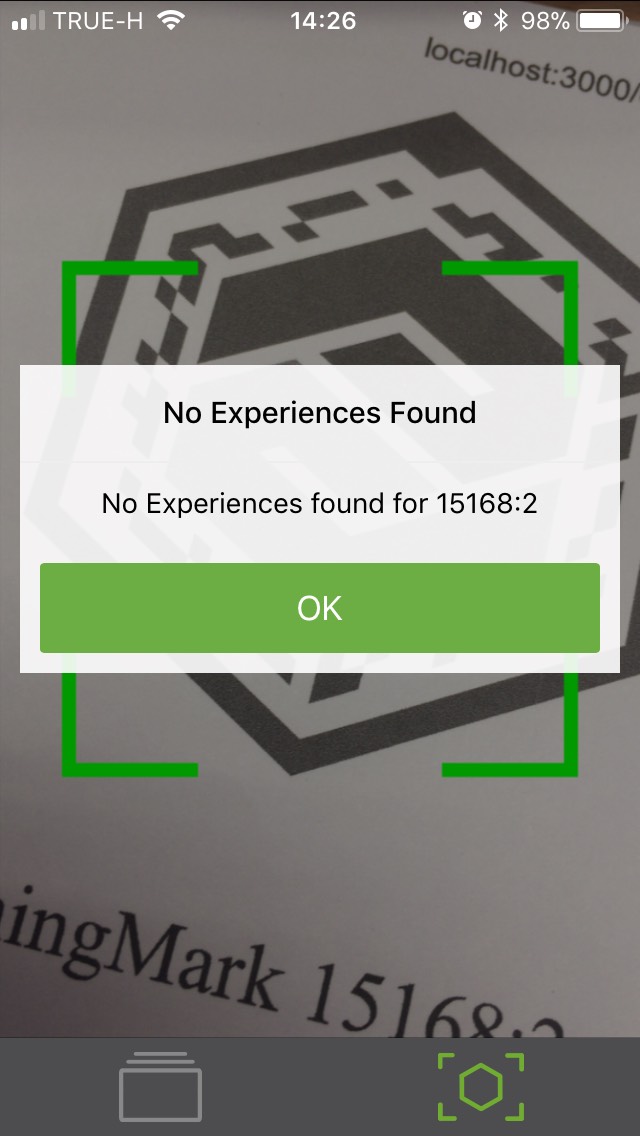

I use thingworx view (8.1.1) on i phone 6 (IOS 11.1.2)
I can't scan thingmark when i use with Spatial Target but it work when use with i phone 7(IOS 11.1.2)
November 27, 2017
Hi Nuttapol. Spatial targets leverage Apple's ARKit functionality. Only iOS devices with an A9 chip or higher can view these experiences. The iPhone 6 does not meet these requirements but the 7 does.
