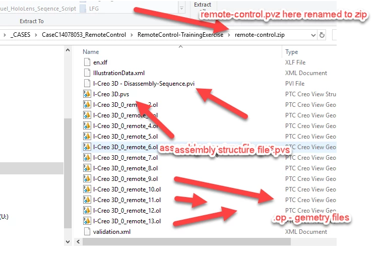

may be here to clarify first -actually  pvz is a zip file which contains the Creo View format : -extension  .pvs - for assembly structure and  .ol for model part geometry. When we embed such file then in Creo  Iustrate .c3di then we can create animation and publish the Creo Illustrate file again to .pvz format . In this case the .pvz file will contain all models which are embed (imported into illustrate) but additionally  it will contains for every animation a text file with extension .pvi.
This file is as mention contains the animation and is text file and could be extracted from the pvz file (simple copy it as zip and extract it)
The format defines for the entities of different components change of the properties and movements ( translation and rotation based on euler transform)
But back to the question- The current tool where you can create such pvi file is Creo Illustrate. So means having the Creo Illustrate license you can import also stl,sla, dwg, dxf, step, iges, vrml  and other which are supported by the most CAD System tools. And then you can create you animation in the Creo Illustrate tool
Currently is not supported the import of animation from othere tools.
The pvi file syntax is internal PTC syntax and is not documented for external usage. But actually it is TEXT format  if you are able to create  it otherwise (mains by some not Creo  related tool) it may work . Of course of this you need a structure of the assembly so I believe it supports only the pvs assembly.
When for example your export form non- PTC CAD tool an assembly to step and then in Thingworx Studio internally  the STEP file (containing assembly)  will be converted to pvz format.
You can find this pvz file in the ..ThingWorxStudio\Projects\<YourProjectName>\src\phone\resources\Uploaded” directory. So now for this file a pvi animation file could be applicable
