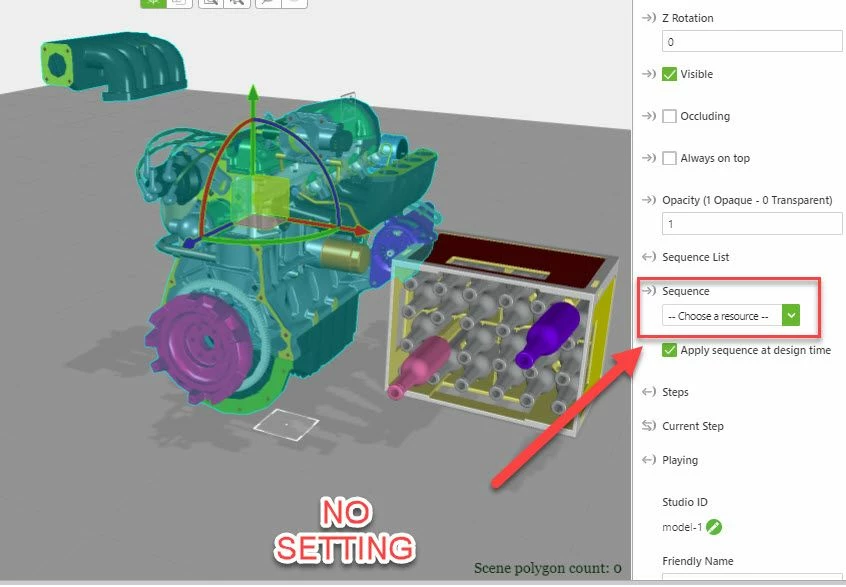

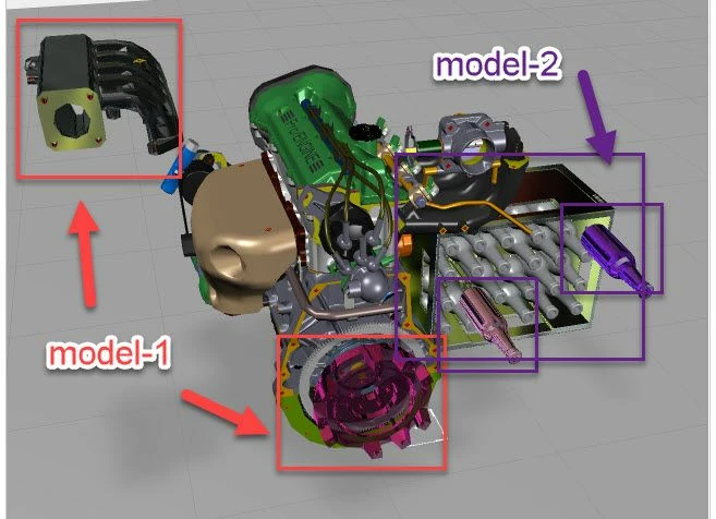

I am trying to apply different shaders on multiple models in a single view. Apparently the usual method is not working. Only one particular model is being applied a shader at a time.

Hi @Ace_Rothstein_310668 ,
when I tested the shader with 2 different models I was also able  to reproduce an issue where the second model does not work.
I used a glass shader. What is not clear if the tmltext shader definition is not working because there is some problem with shader implementation or this is a general studio issue.
I tested the issue further and it was strange that then it was working when I set the first model (where the shading was display ok) to invisible - model visible property was set to false . The display on the both model are working fine for selected modelItems / This was working in preview and on IOS Ipad 6 device. But later when I tested it again I have again an issue.
After some further checks  in the end I  found that it works with several models when you do not set the sequence property. In this case shader settings are displayed   ok

The shader was displayed ok in several modelItems widget on the both models
Seems that there is a general problem when we set the sequence property of a model and try to apply shader on several model widgets.
You can test if you disable this property  e.g.
 $scope.setWidgetProp("model-1","sequence","")
You can try to merge the several models to one assembly but  I believe that there always an issue could occurs  when we try to use at the same shader and sequence on the same model.

Feb 29, 2020 6:00 AM UTC
Hello @RolandRaytchev!
       Thank you for your solution. I attempted to run the code in your described method and it has worked successfully. It was great help! Thank you once again
