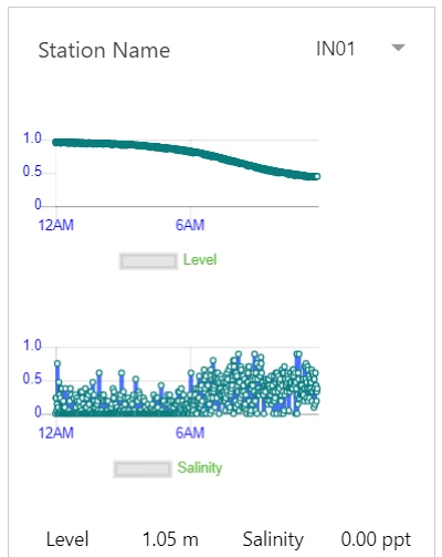

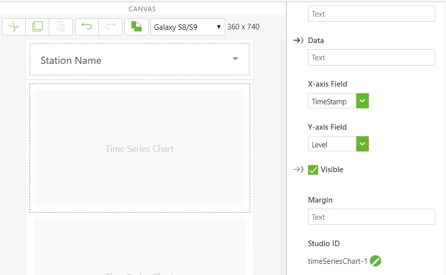

Can we do multi Y-Axis in 2d widget , vuforia studio
Can we do multi Y-Axis (In this case i would like to show level and salinity in the same graph on y-axis , timestamp on x-axis)

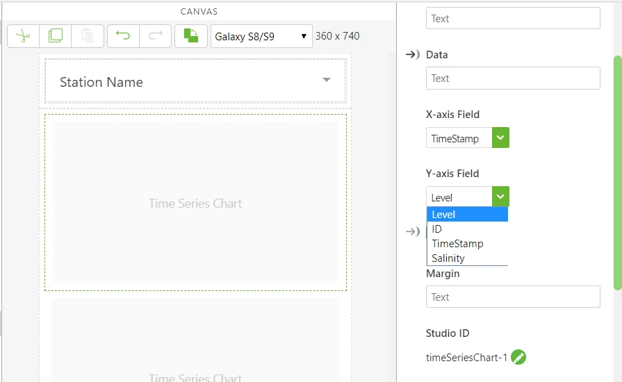

in properties, i think it can't
Are there any trick?

To be honest, today, I am pretty sure that it is not possible in Vuforia Studio with the Time Series Chart Widget.
Y-axis field is not a multiple select item Widget.
