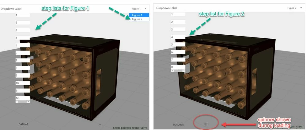

May 1, 2020 5:09 AM UTC
Can you Please Share Any Demo Project ?
May 4, 2020 12:57 PM UTC
Because I did not have a project with a  sequence  which requires a long loading time , therefore I did not have such example. Although I have  large models with a complex sequences but I could not publish here because they contains confidential data could not be published in the community. To be able to simulate the waiting on loading of large sequence this I used a delay =5000 inside the $timeout(, delay) ; service.
So the code which called is something like:
//makes the spinner visible and then load the sequence
 $scope.setWidgetProp('spinner-1', 'visible', true);$scope.$applyAsync();
 $timeout(function () {
 $scope.$applyAsync(()=>{$scope.setWidgetProp(modelName, 'sequence', 'app/resources/Uploaded/l-Creo 3D - '+sequence +'.pvi');});
 },50);
// event which is called when the sequnece loading is completted
$scope.$on("sequenceloaded", function (evt, arg) {
 let delay=5000;//it should be 0, but to loading is too fast
//in this exampole therefore I will blank the spinner wdg with delay 5secs
 $timeout(()=>
 {$scope.setWidgetProp('spinner-1', 'visible', false);$scope.$applyAsync();},
 delay);
I adapted a demo project to demonstrate the suggested option  and attached it to this post
