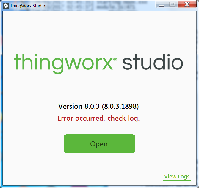

Cannot install thingworx studio 8.0.3 (8.0.3.1898): "Error occurred...", Windows 7 Ultimate x64. Help!
ASUS N76VB
Memory = 8GB DDR3
NvideoGeForce 740
I download setup.exe from https://studio.thingworx.com/home/
I cannot install this application on my ASUS with the following reports:
[09/03/2017 02:45:34] Studio Version 8.0.3 (8.0.3.1898)
[09/03/2017 02:45:34] Status Message: Version 8.0.3 (8.0.3.1898)
[09/03/2017 02:45:34] Checking for updates from https://studio-download.vuforia.io/downloads/ThingworxMobileBuilderApp.application
[09/03/2017 02:45:35] Starting node.exe
[09/03/2017 02:45:37] module.js:471
[09/03/2017 02:45:37]     throw err;
[09/03/2017 02:45:37]     ^
[09/03/2017 02:45:37] Error: Cannot find module 'debug'
[09/03/2017 02:45:37]     at Function.Module._resolveFilename (module.js:469:15)
[09/03/2017 02:45:37]     at Function.Module._load (module.js:417:25)
[09/03/2017 02:45:37]     at Module.require (module.js:497:17)
[09/03/2017 02:45:37]     at require (internal/module.js:20:19)
[09/03/2017 02:45:37]     at Object.<anonymous> (C:\Users\Admin002\AppData\Roaming\ThingworxStudio\studio-download.vuforia.io\dist\server\utils\logging.js:19:15)
[09/03/2017 02:45:37]     at Module._compile (module.js:570:32)
[09/03/2017 02:45:37]     at Object.Module._extensions..js (module.js:579:10)
[09/03/2017 02:45:37]     at Module.load (module.js:487:32)
[09/03/2017 02:45:37]     at tryModuleLoad (module.js:446:12)
[09/03/2017 02:45:37]     at Function.Module._load (module.js:438:3)
Before it I used 8.0.2 on this ASUS.
But now cannot install 8.0.3 on it.
I did it several times during three days with the same result.
How can I really install this upgrade on my  notebook?
Thank you in advance.

    Sep 4, 2017 12:00 PM UTC
    Hello Durgesh!
    Thanks for your message.
    I check the file system: no, I didn't install node.js separate or externally.
    And during last attempts to install 8.0.3.1898 I deleted all directories/files from C:\Users\Admin002\AppData\Roaming (and last case - the ThingworxStudio directory from C:\Users\Admin002\MyDocument too).
    But even after that I see the same installation message:
    - Studio Version 8.0.3 (8.0.3.1898)
    - Status Message: Version 8.0.3 (8.0.3.1898)
    - Checking for updates from https://studio-download.vuforia.io/downloads/ThingworxMobileBuilderApp.application
    - Starting node.exe
    - module.js:471
    -      throw err;
    -  Error: Cannot find module 'debug'
    -      at Function.Module._resolveFilename (module.js:469:15)
    -      at Function.Module._load (module.js:417:25)
    -    at Module.require (module.js:497:17)
    -      at require (internal/module.js:20:19)
    -      at Object.<anonymous> (C:\Users\Admin002\AppData\Roaming\ThingworxStudio\studiodownload.vuforia.io\dist\server\utils\logging.js:19:15)
    -      at Module._compile (module.js:570:32)
    -      at Object.Module._extensions..js (module.js:579:10)
    -      at Module.load (module.js:487:32)
    -      at tryModuleLoad (module.js:446:12)
    -    at Function.Module._load (module.js:438:3)
    Any idea?

    and in this case ThingWorx Studio installed and run well: I  could move  my own "old" projects here and can start here new projects.
    I try compare log from my bad case and that good case, I compare them from the beginning message to "Start node.js" message and find the difference :
    "My bad and error installation":
    - Starting node.exe
    otherwise, in good case I have the following:
    Status Message: Performing First Time Setup (Application)...
    Removing C:\Users\Admin002\AppData\Roaming\ThingworxStudio\studio-download.vuforia.io\dist
    Unzipping mbdist.zip to C:\Users\Admin002\AppData\Roaming\ThingworxStudio\studio-download.vuforia.io\
    Status Message: Performing First Time Setup (Libraries)...
    Removing C:\Users\Admin002\AppData\Roaming\ThingworxStudio\studio-download.vuforia.io\node_modules
    Unzipping mbmodules.zip to C:\Users\Admin002\AppData\Roaming\ThingworxStudio\studio-download.vuforia.io\
    Starting node.exe
    I underscored logs in the successful case addressing the steps (before start node.js) which cannot perform in the bad case. - What does it mean? Why I cannot install Applications and Libraries at all? May be it is a reason.?
