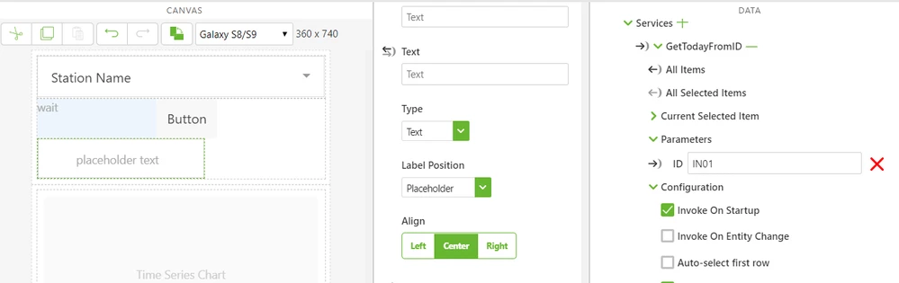

Cannot pass TextInput (text) to service parameter
What i would like to do
- I would like to pass parameter to service I created.
           -service is call to rest api end point with reply json format data of water level (measure all day in each minutes).
           -i convert to infotable and got data shape as (ID,TimeStamp,WaterLevel).
           -endpoint url is look alike getdatafromID/<ID-name>.
            for example, my ID-name is IN01,IN04
What i have try
- i try concept to create graph on mashup by putting ID-name as text input, It's work
- i try on Vuforia 2d widget time chart it's not work.
      - I use textInput (text) to input ID-name i want to call on server
                 -bind textInput(text) to Parameters(ID)
                 -bind event(valuechange) to GetTodayFromID(service called)
                 -I also create function to catch log that what data really passed to (figure 3 below)
                 -data is not load
                 - i configure option as "invoke on Startup" and "refresh" data is not load
But
    - If i use default input for ID as IN01 data can be loaded But just only the default(IN01 in this case) I cannot change to IN04 while on preview
How can i pass TextInput (text) to service parameter.

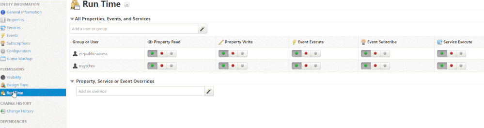

1.) the method you tried to use has no permission for the user. In the old Thingworx 8.1 it look like this:
One time we can do the setting for the particular user and one time for the public user
Here I did set the permission for all services and properties, but you can set the permission only for the required service

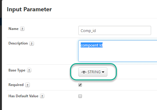

2.) the second problem, may be, is  the wrong parameter- so need to check if we need to convert the sting parameter to other type parameter- so for example you can check that the service will use a string parameter
Later you can convert it if required to e.g. Integer or double

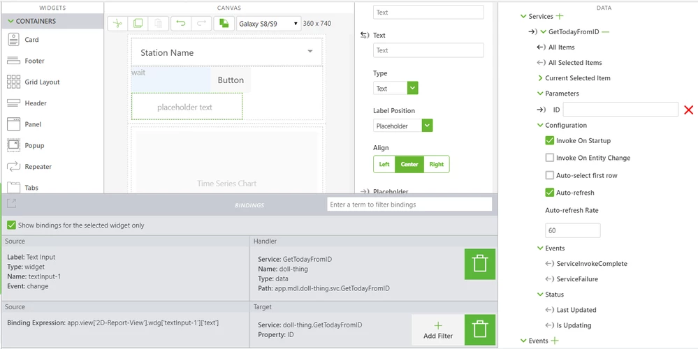

Here I wanted to add that no configuration is required and  should be set because the service is call directlly - means you need to deselect the option Select on Startup and Invoke on Entity Change and Auto Referesh because the call should be done from the textInput widget change event so far I see the attached picture
Paitoon1-VisitorAuthor
Oct 24, 2019 9:56 AM UTC
Thank you Mister,
        I finally found that issue is about default called that im not set to somewhere and make the whole system response in weird.
I will talk about this soon but im in very busy progress.
i will update this next week

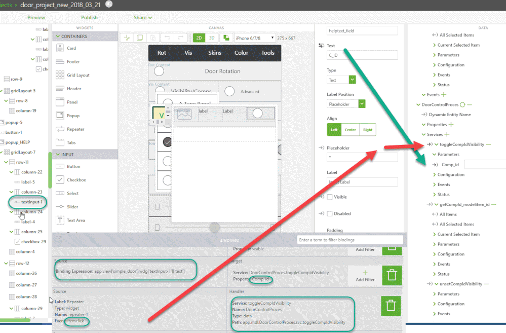

we can also call the method form javaScript (still this requires as mention in the previous post that the permssion are set correctly)
Example:
//this function is called by click event of repeater
$scope.clickRepeater = function() {
 console.warn("function $scope.clickRepeater() with::"+$scope.view.wdg['textInput-1']['text']);
 $scope.toggleCompIdVisibility($scope.view.wdg['textInput-1']['text']);
