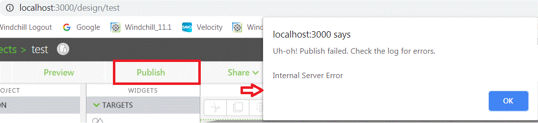

Can someone help me on this to be working in my laptop. Two months back,  I managed this issue by accessing from a new workstation. Right now customer has purchased license and so I need to make it work on my laptop,
When I click the "Publish" from Vuforia Studio, it pops out error window as "Local host:3000 says, Uh-Oh ! Publish failed.Check for log errors. Internal Serrver error"
I have attached screen shot and log files herewith.

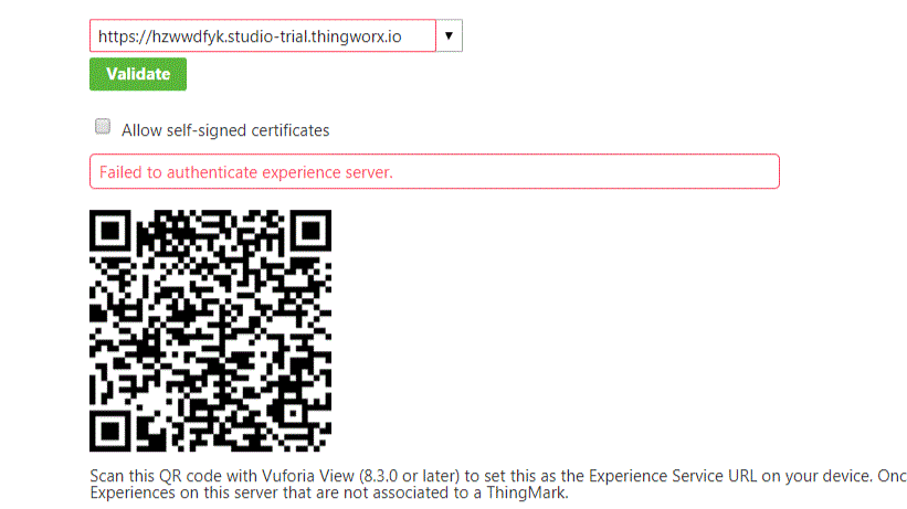

adding the error on experience server...

@rsingaram Could you please confirm if you are able to validate the Experience Service from project configuration->Info tab.
Also, could you please confirm if you are able to see your Trial service is active by login into https://studio.vuforia.com/login/
If possible attach the snapshot post login to above URL.
Durgesh

Studio is able to publish in another fresh computer using my login.
So I cleaned up registry entries and local files related to Studio.
Now I can publish - Resolved..
