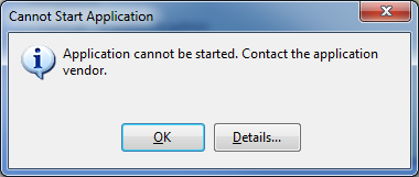

I have install thingworx studio 8.1.3.
However Thingworx Studio cannot be started.
How can I do ?
Below is detail log.
ERROR SUMMARY
Below is a summary of the errors, details of these errors are listed later in the log.
* Activation of D:\Users\kjoono\AppData\Roaming\Microsoft\Windows\Start Menu\Programs\PTC Inc\ThingWorx Studio.appref-ms| resulted in exception. Following failure messages were detected:
+ Activation failed.
+ Access is denied. (Exception from HRESULT: 0x80070005 (E_ACCESSDENIED))

Joon O Kim​: Could you please try deleting the files under <user home>\AppData\Local\Apps\2.0\ and re-install the studio .exe file.
Do Run as Administrator when launching the Studio application.
-Durgesh
