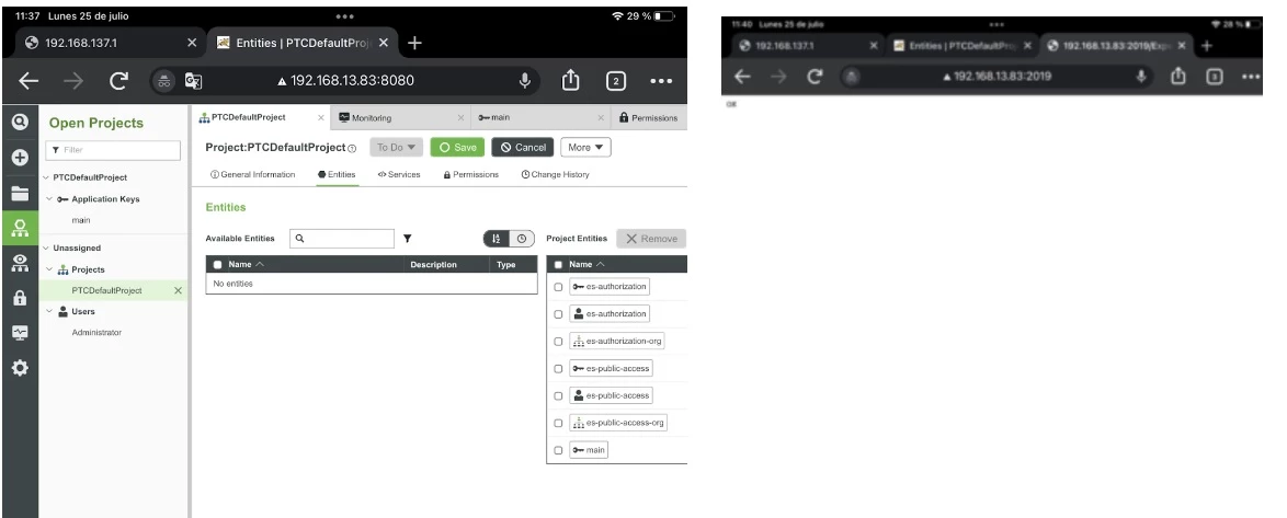

Jul 25, 2022 12:47 PM UTC
HI i reviewed everything you said.
https://docs.google.com/document/d/e/2PACX-1vScF_rSPrZjnNE3brEyyQ7mSAz77zIEfImYiGNPoVV_JVCh0TA8ho7H7PDB1MBDionV_aJ_h0i_KXFo/pub you can check the thingworx permissions point.
twx and experience service screenshot from device attached to this reply.
- make you experience... -> yes it is public and publishes well
-set the Allow self-signed certificate ... -> where should i achieve this? this is the only missing point
- on the mobile device you can set the ... -> done but no visible changes
- and , please, check the following... -> i checked everything and updated in the docs with screenshots, can you make a list of which services/ runtime permissions do i need?
I really hope you can help me to get this working, very greatful for the help. Thanks, waiting for the answer.

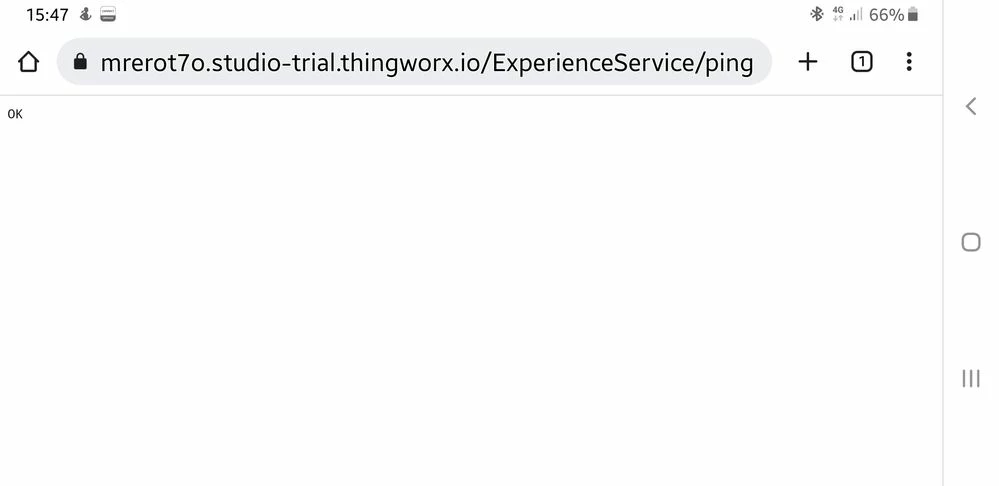

Jul 25, 2022 1:52 PM UTC
I did not see info about the pont
on Browser on mobile device calling a ping
<expereinceService URL or UP>:2019/ExperienceService/ping
Is there a OK returned? Example Chrom from Android:
When it is not visible all others settings does not make sense. If the server is not visible on you mobile device  the most important thing is to see why it is not visible. You can try with the IP address  instead of the URL - possibly the domain of your server is not resolved on the mobile device
