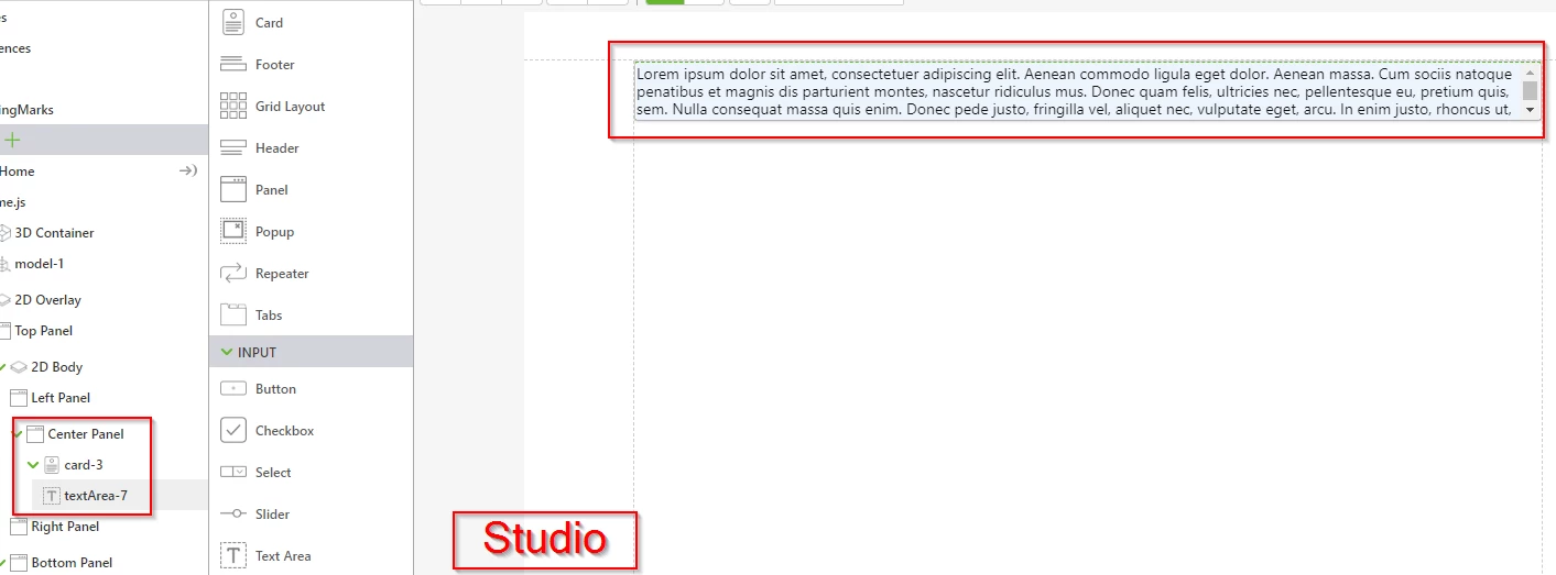

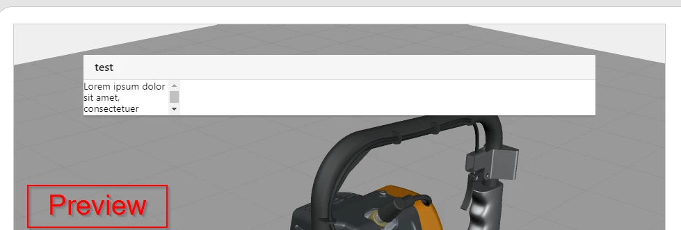

Card small text area
When using a Card, with a text window, the text window appears very small?
The text window works perfectly in an popup so it must be the card.
Adding grid, also no effect.
See attached pictures.
Dec 10, 2019 1:34 PM UTC
Hello  svlaminck
add class width-100pc to the Text Area widget and add this code:
.width-100pc {
 width: 100%;
to the Application STYLE.
Regards
Tomas
