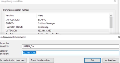

Jul 4, 2022 1:55 PM UTC
Seems that by default Vuforia Studio only listens on localhost / 127.0.0.1 interface.
The behaviour is defined in 'AppData\Roaming\VuforiaStudio\studio-download.vuforia.io\dist\server\index.js' file on line 128
var listenInterface = args.listen || process.env.LISTEN_ON || 'localhost';
So you can just add a 'LISTEN_ON' environment variable (preferred) or overwrite the variable in the .js file (it will probably be overwritten on the next Studio upgrade). Will probably have to restart Studio after setting the vartiable.
There is probably a third way - adding an argument to the Studio start command, but I never cared to find it.
